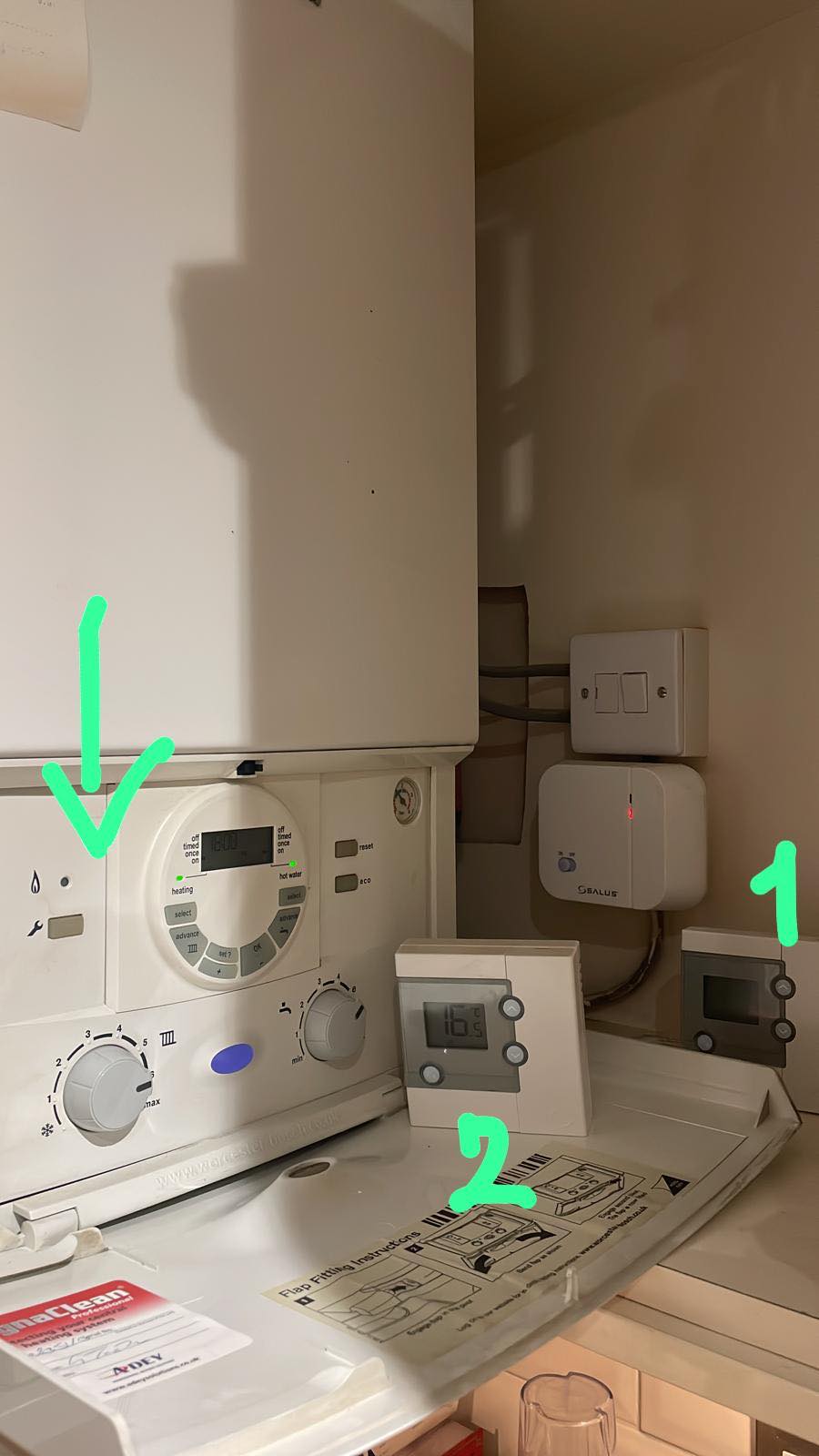

Could it be a problem with the boiler? The hot water is working but radiators not coming on.

Thanks for the advice. Is there a reason why the gas light isn't on or is it just a thermostat problem?
Because the boiler does not know that the thermostat is calling, because it is not paired with the receiver, as @Exedon bin the Salus, the EPH are good but there are others too, if you need a temp measure to get the heating on we can advise you how to do that but the thermostat will be over ridden so only controllable at the boiler
