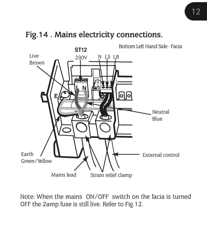

Now we have a Worcester Si25 with a digital time on the front. TRV's on all rooms and no thermostat anywhere.
WHat options do I have for controlling the combi boiler?
As cheaply as possible, even just using a smart switch to close a contact to turn it on/off will do.
Bar getting a new boiler (which is on my mind for the coming future) suggestions please?
Do an internet search for Alexa/voice activated thermostat. Pricey though in some instances.
Boiler connections for a 'stat on a 25 Si...
Cheers, so will shorting LR to LS turn the boiler on?
This I can do with a smart relay instead of a thermostat?
We don't have a thermostat and if we did er indoors would turn it right down and glue it there :(
