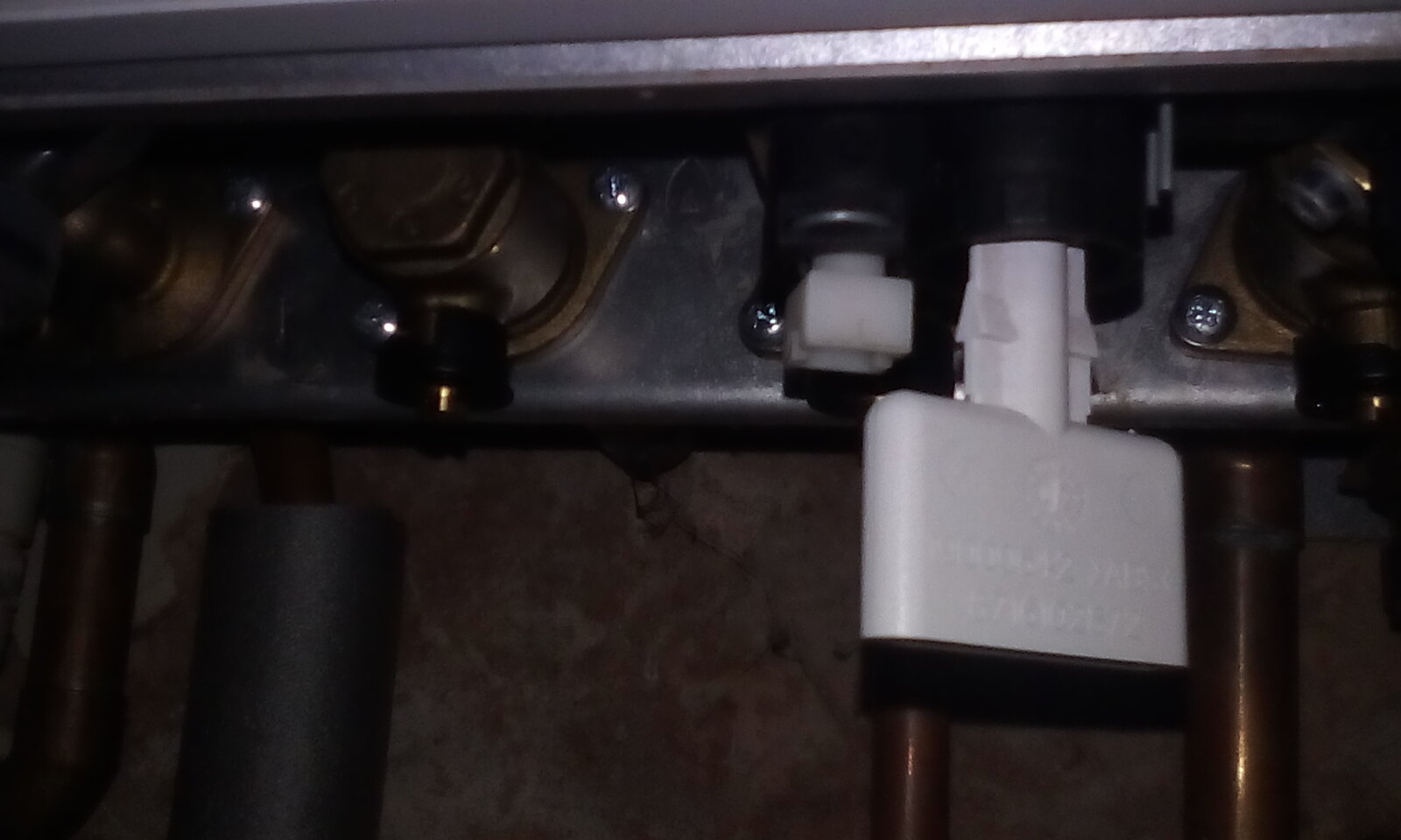

cannot push white key in to allow water top up!
can u i out some grease on it?
thanx for any replies..urgent!
pic shows it in but engineer pulled it out last time he called, he had a job pulling it out!!!
now i need to add water but key wont go fully in and dont want to break anything?

Try a bit of vaseline on the rubber ,
silicone grease is best but most people wont have it
magic, i had sum silcon spray, worked a treat!!
i have another problem now, i had a burst pipe under floor boards and lost water, how do i refill it, have opened the small valve alongside the white key, water goes in but water guage went to 3 bar and only put in about a cupful?
is there a special way to refill system, i have undun a couple of rads to bleed and water cums out.
any help!..is Really appreciated as i have no heating at present!
