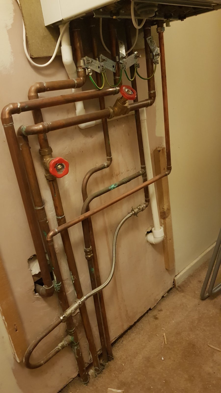

Evening all,
Wondering if someone could advise me on a query on the Greenstar 28i Junior Combi boiler I have in a property I let out.
In process of tenants moving out, with new ones due in end of the year, but had look at the plumbing set up and found something wasn't sure about.
Basically, the pressure when topped up, never holds and drops away to zero quickly. Its the external filling loop way, not the internal or the key.
Now when topping up the pressure, its on the Domestic Cold Water Mains inlet, but when trace the plumbing on it, its connected to the CH Return also..... is this correct?
Will try load a pic if I can!!
Hopefully someone can assist me! TIA
Filling loop takes water from cold feed ,via non return valve ,into ch sealed system. If loss of pressure at boiler gauge then water is leaking out the sealed system.

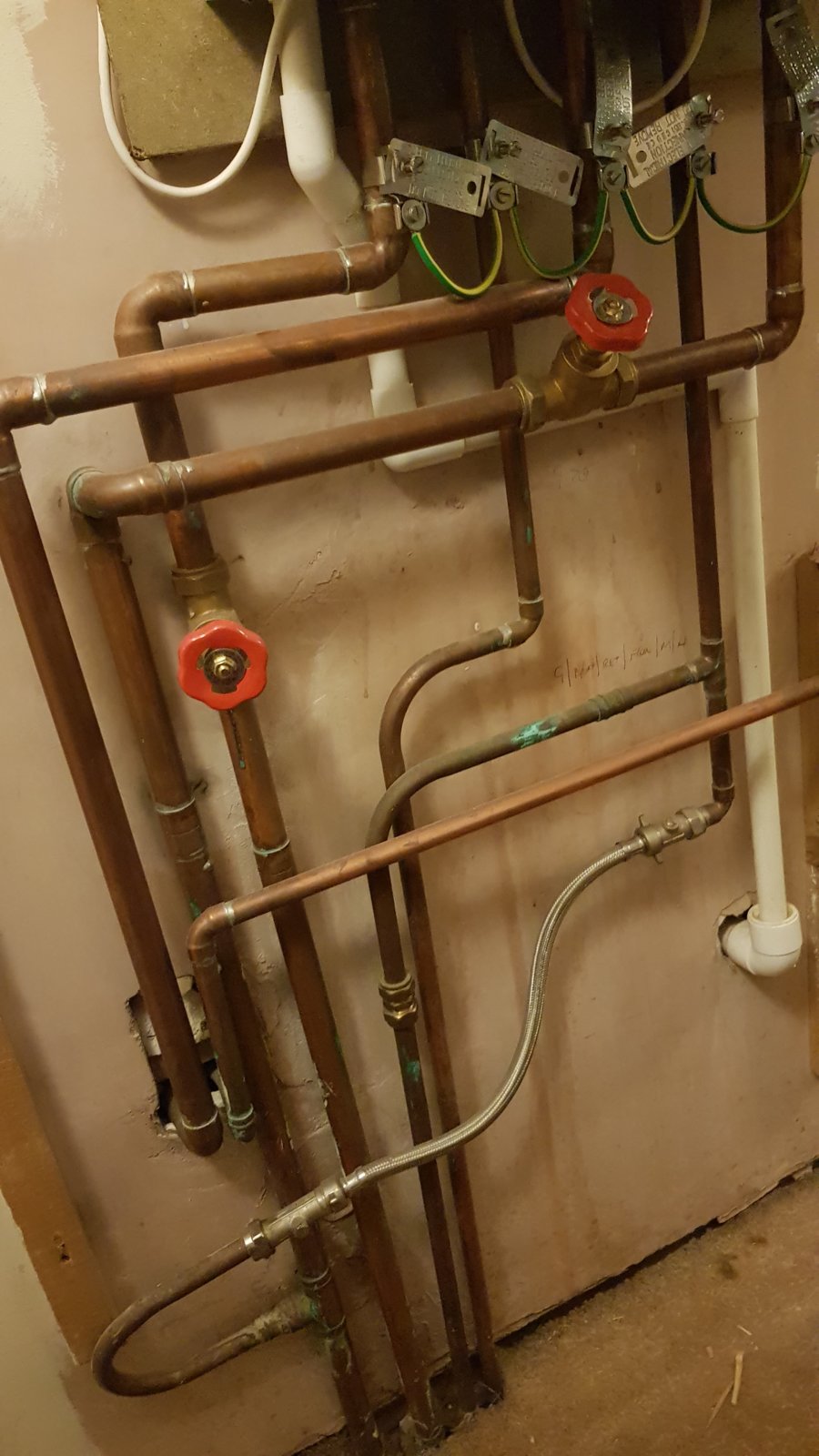

pics attached.....
any common areas for leaks terryplumb?

Anywhere on the rads and pipework ,or within the boiler its prv pipework or condensate drain ,unfortunately. The most obvious for you to check first would be all visible pipework and radiators and their valves. When system is cold ,top up to 1 bar and run central heating ,look outside for a copper pipe sticking out the wall ,close to boiler location. Thats the prv pipework ,see if it drips water ( it shouldnt ) ,thats a common problem .

You now need to find out where the water is getting out. Has heating been off over this period ?
Its either a leak on the system ,pipes ,rads etc.
Or from the boiler itself.
You could isolate the boilers flow and return and electrics, after topping pressure to around 1.5 bar ,and leave it for a day or two. If pressure has then dropped its the boiler.
