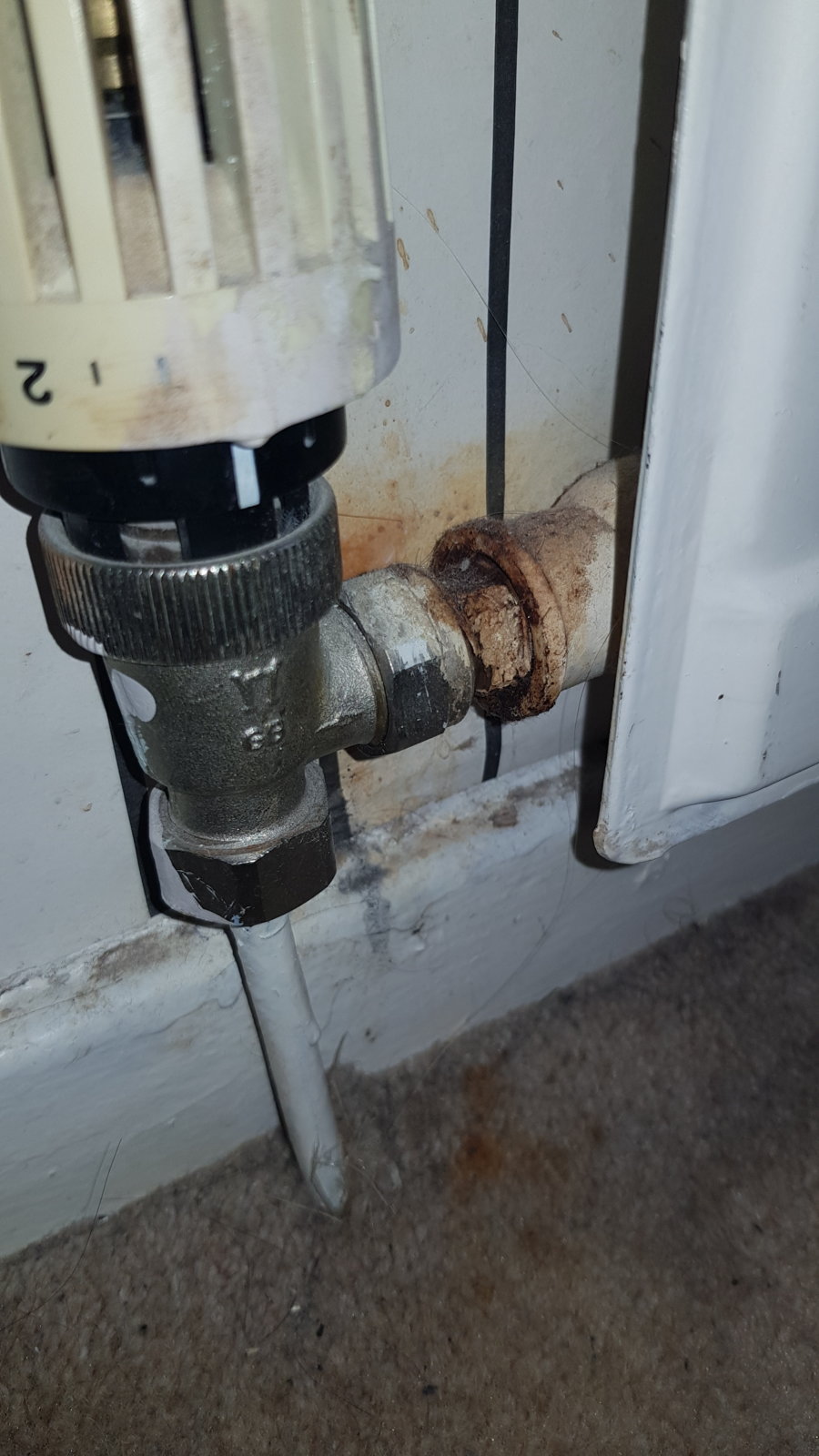

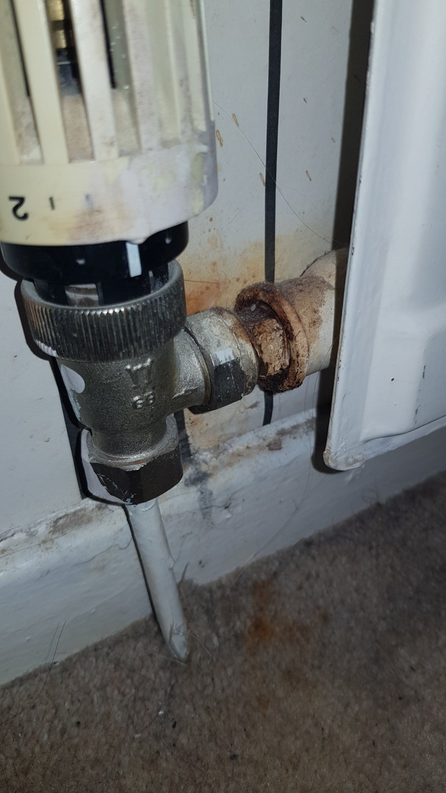

so had the prv pipe undone for 6 days, small plastic bag over it with paper inside to see if any water comes into it.....none.
The pressure was set at 1.5bar and has dropped to around 0.2bar when off and goes up to 0.7bar approx when heating is on.
CH and HW both fine.
2 rads look like have had leaks in the past, attached 1 of them in pics, going to some toilet paper round them see if any moisture over a day or so.
