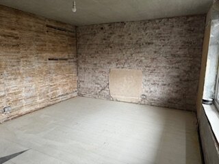

A couple of photos below, I can get more later. The door is just out of shot on the left. 'Aesthetically' that wall is where I'd like the wardrobes to go, anywhere else and the door will limit the available space and overall aspect. However I do want to avoid a damp problem down the line and will do whatever's needed.
1920s built, cavity, chimney breast on the external wall which is rendered. As you can see there's been a fireplace at some point, that's a hard render over the area, no airbrick. Below, in the living toom, a fireplace has also been removed, there's an airbrick there. There's never been a problem with damp in either of the rooms.

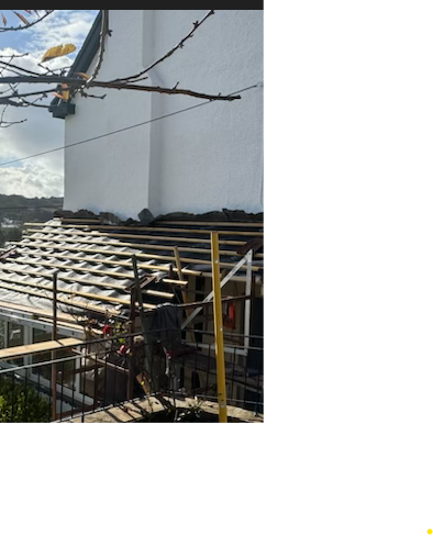

Thanks for the exterior pic - however, it wont expand for me. So I cant see the state of the render.

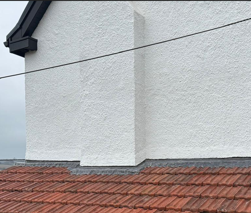

Thanks Ree - the original photo was too big to upload so I had to compress it. Same with the attached, but I've used less compression.

The freshly painted gable render in the pic looks OK.
No, just D&D the insulated p/b onto the brickwork.
