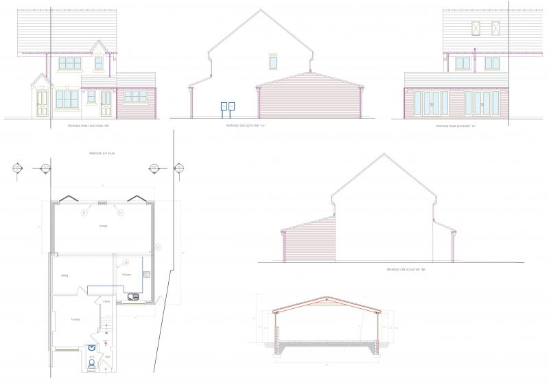

I'm currently considering extending our house on the ground floor.
I've drawn up some plans (at about 75% at the moment - see below) of how i would like it.
I'm a bit restricted with height by the first floor rear windows (bottom of window 3750mm from ground level, 3600mm from DPC) but i would like to extend out 4m from the rear which results in a pitch of 15°.
Due to the neighbour consultation scheme, i assume 4m would be acceptable on an attached house, can anyone advise if i'm being naive with this? I will be submitting full planning permission as from what i've read wrap arounds are not covered under permitted development. Can anyone advise if this is so or could i get away with neighbour consultation scheme for rear + permitted development for side?
Plus, any constructive criticism of my first drawing attempt would be appreciated!

If you are confident no neighbour would complain, you could try the 4m extension across the rear under the notification scheme. But you would still need planning permission for the side bit because it would extend rearwards more than 3m beyond the original rear wall.

Watch that roof pitch as you are very limited with the choice of roof tiles.
It's on a new build estate and a neighbour has built an 8m deep garage to the side of their house very similar to mine, that has a 15° roof and has the same tiles as existing so there should be something available to me :)
It's the eaves details that's concerning me as i'm not that familiar with it, for example, would the below be correct? *puts on flame suit*

I've gone into this detail to see the pitch was >15°

Just because your neighbour has done it does not necessarily mean you will be able to. Investigate the tiles now, there have been many a thread on this forum whereby Building Control has refused a particular tile for a low pitch roof as it was below the manufacturers quoted minimum pitch.

On the eaves sketch, I suspect your lintel is too shallow for the span of the patio doors.
Yes, you will have to watch the roof pitch. If you are going to have rooflights
(which might be necessary on that length of extension) you will be limited to a 15 deg. pitch.

Thanks, to be honest i think i've left a CGE90/100 "eaves linel" on the drawing, i'll have to change it to a standard CG90/100 which is a bit higher. That'll affect the size of the block on the inner wall, up to ~100mm from 65mm. Every mm is counting at the moment to try and keep the pitch up!
That's why i'm trying to stick to 15° so i can fit velux windows ok.

Or you can just raise the ridge/pitch and you detail a little flat roof beneath each window. Its a pretty common workaround.
By a bit of judicious working, you can also slim down the raftrs. Don't just take the size from the tables - they're generally very conservative.

As the span is approx 4.3m, off the top of my head, the size i got from the table was 200x63?
Too big.
TRADA tables are conservative. On that span you could easily get down to 7x2s if at slightly closer centres than 400.
If it helps to save a bit of height, you can also birdsmouth deeper at the eaves - the bending stress is not critical here.
Have you thought of putting a steel purlin across running side-to-side? That way you could split the span and get down to 5x2s.

A steel purlin running side to side would definitely be an option, i assume this would take up an extra ~70mm depth to the roof (ie, vaulted ceiling level lower)
Are 8m lengths easily available?
I think i've been measuring the span wrong, from wall plate to wall plate is more like 4m.
