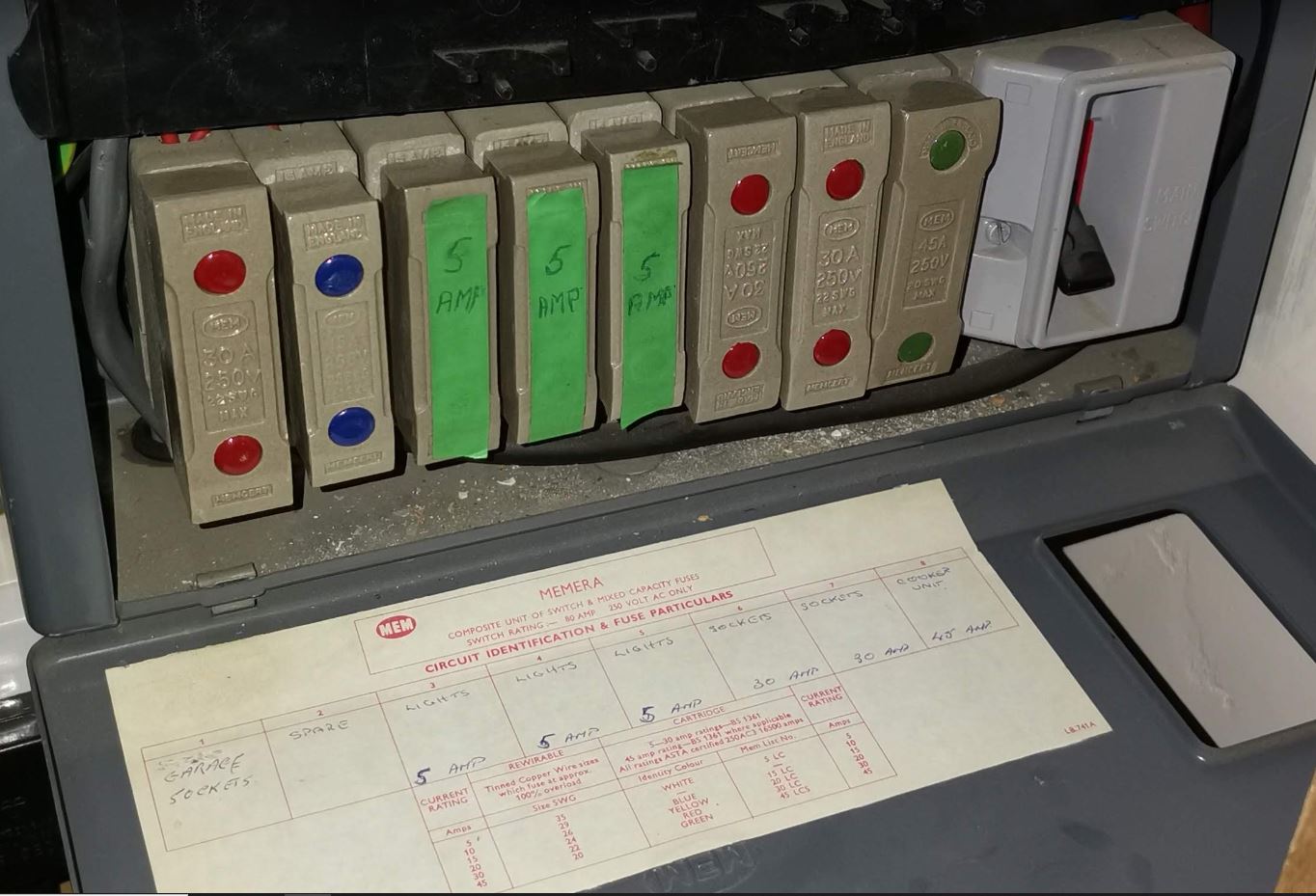

My mums house has still got the old fuse wire fuses, was looking to get the Wylex push-in MCBs
on the fuses it has
30a
5a
45a
on the Wylex mcbs i've seen, they have 6a, 32a and i can only see 40a ones not 45a
is it ok to change them out?
will the Wylex mcbs fit a Memera board?

No.
There are no MCB replacements for that fusebox.
Even if they existed, fitting them would be entirely pointless.
A fuse provides protection against overloads and short circuits.
An MCB provides protection against overloads and short circuits.
There is no additional safety replacing one with the other.
That fusebox contains asbestos, and should have been replaced several decades ago.

oh, ok, i'll see about getting it replaced

So step one is measure the insulation resistance, or the earth leakage, you need to know if an RCD will hold in, no good after new board fitted finding some circuits are US, need to know before you start.
It is easy on here to say you need a new consumer unit. But in real life you need to consider more.
