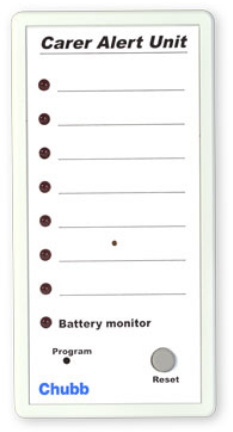

I have at the moment a problem with an alarm sounder, it is too high pitched for me to hear, next to it I hear the high pitched pulses but with bedroom door closed just hear white noise. The instructions are useless
all they say is the unit can be used with a selection of devices it does not say how to program anything. The battery is removed so I can switch it off with a smart socket before carers arrive.
