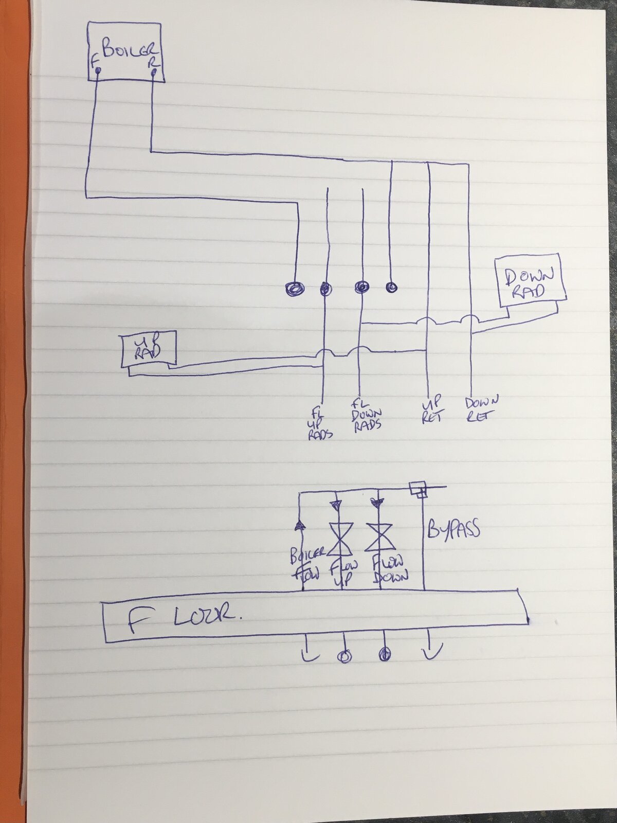

Is this the best way to do it or is there a better easier way ? All the ceilings are down and i’ve ripped out all the 10mm blocked copper feeds and circs back to a metre from the boiler (combi).
Easy way to zone is fit programmable TRV heads to the valves, every room then independent, can't see point in zone valves unless like this house large area not often used, my granny flat I can turn off.
Good call ditching the 10mm. Your scheme will work fine (check boiler manual for minimum pipe length to bypass) but is unnecessary with TRVs fitted (for B Regs compliance). That said, I've zoned every house i've lived in for upstairs and downstairs....
Cheers. Thought about taking the up/down returns into the cupboard and teeing them together (instead of under the floor) but it would make it a bit tight in there. Would that’ve been the better option ?
Without seeing the space its hard to tell, main thing is to keep the runs as smooth as possible (ie avoid loads of elbows)
