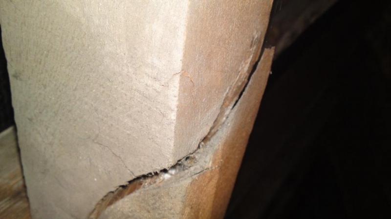

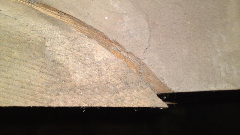

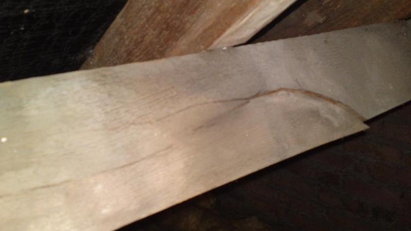

When venturing into my loft this weekend I find I have a quite badly split Purlin, home insurance will not cover and suggest I sue my surveyor....not much help there then.
I have little or no spare cash so all advice is appreciated, I have added pics in My album space!

Welcome.. might be able to do remedials with a some steel angles bolted through the purlin to strengthen it at the weak spot..

Do you have a drill?
If so, you can splint it. Get a couple of 1m lengths of timber, the same depth as the purlin and 50mm wide. Clamp or temporarily screw 1 either side, drill through the lot every 150mm with a 12mm drill bit and pass some 12mm bolts all the way through.
Sandwich a toothed timber connector between the timbers and use square washers under the bolt head/nuts.
If you have a hacksaw, 12mm threaded rod would work out a bit cheaper than bolts.

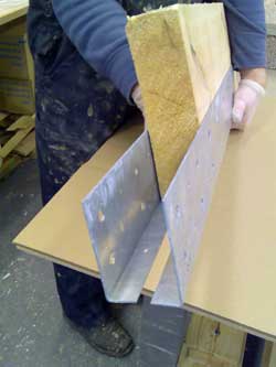

This is the kinda thing i would be thinking of.. locally plane off the bottom of the split.. possition a couple of decent angles each side and with staggered holes.. then bolt through the lot..

Where might one go about getting one of those brackets? Also I am assuming that it'd be horrendously expensive to get a roofing company to replair the purlin? Problem is that I don;t want to be in this house forever and don;t want any form of issue with survey when selling!
Can you put a strut under it? it would be cheaper, easier and work.
wont cost a fortune at all , fairly common a good chippie will sort it in no time.

Done it this way many times, IMO I would go 1m each side (2m length) and staggered the bolt holes
1/4" steel plates and coach bolts both sides of purlin extending 8-12" past damaged area will be an effective repair a lot stronger than the original timber
