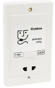

Here is a typical shaver socket:
Note the words on the front ' Shavers Only'. All shaver sockets have this wording.
Rather obviously, this means no toothbrushes.
They are designed for an electric shaver which is plugged in, used for a few minutes and then unplugged. Nothing else - including rechargeable shavers which are left on charge for hours/permanently.
