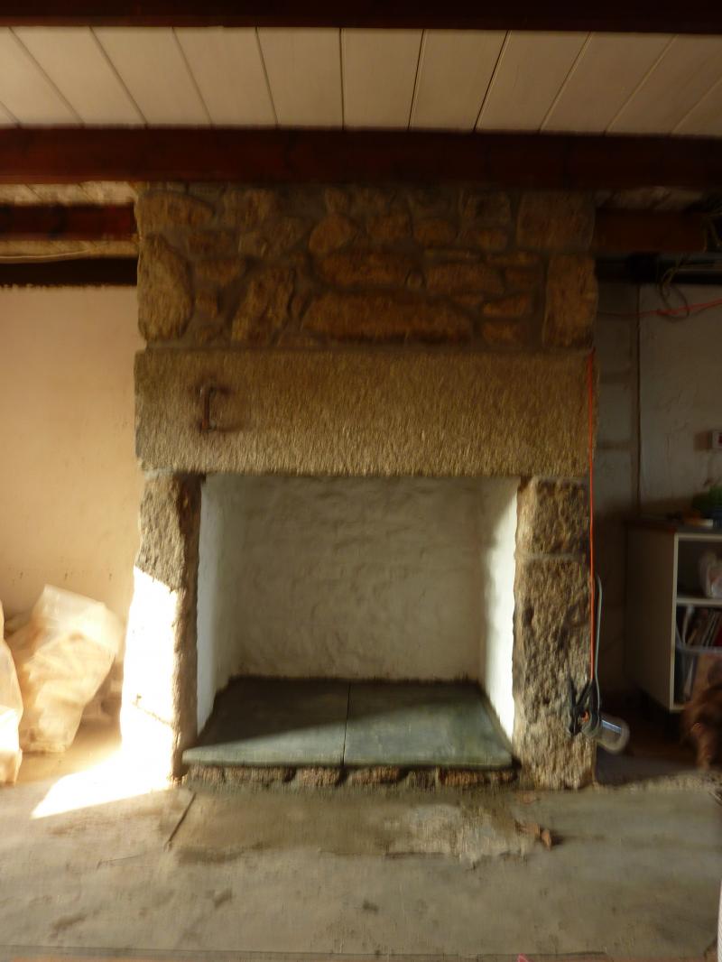

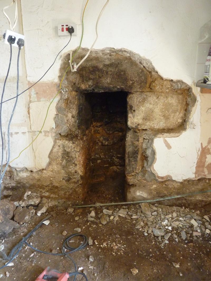

Hi - We have a little cottage in Cornwall and we decided to chip back the horrid 1970s fire to see what was originally behind ... we were hoping to find a large granite inglenook and lintel and hoped a small wall was all that stood between us and a nice wood burner ... how wrong we were ...
... sadly as you will see below, the large granite lintel was broken out when the 1970s fireplace was put in ...

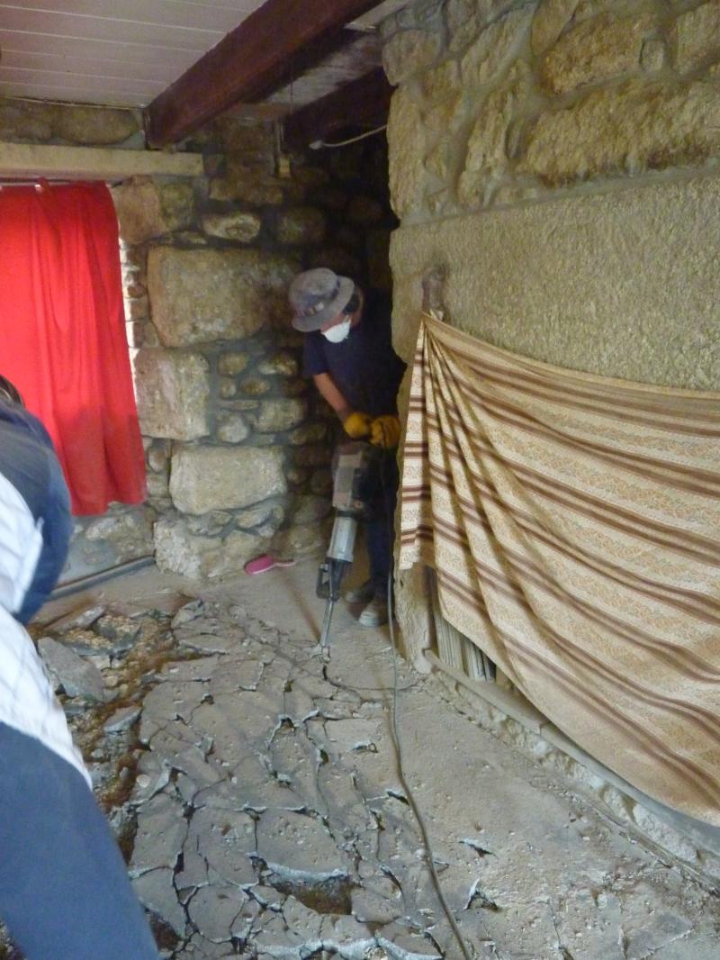

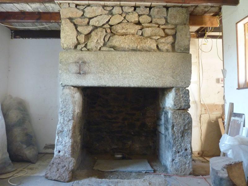

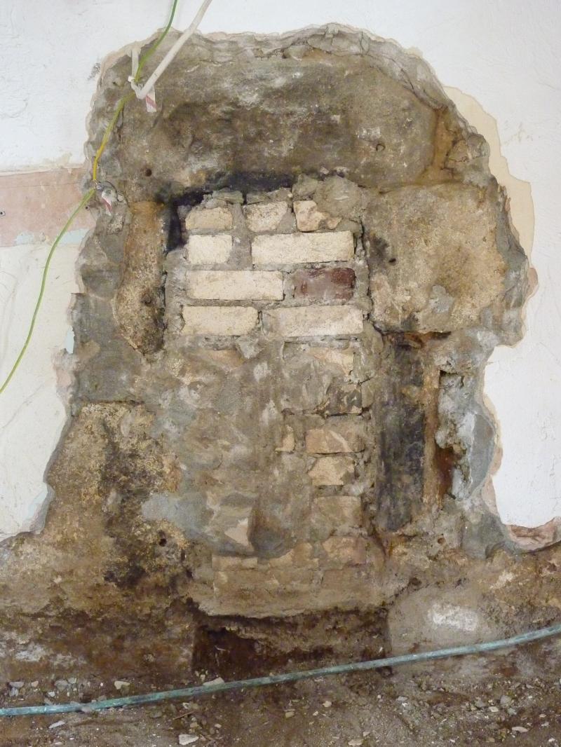

... and unfortunately it was primarily filled with concrete blocks laid side on all the way back (the little lintel in the last pic even had 6 reinforcement bars within it!) ...
... our main concern was the structural integrity of what was above but we thought whoever did this must have built it with the top remaining sound, having not seen this before we were unsure how to proceed ... we carried on chipping it out anyway ...
... thankfully we could then clearly see how the inglenook was constructed and how the inside was filled – all very stable ...

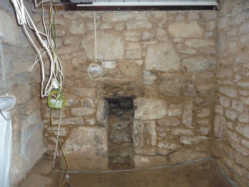

... we finally found the sooty back wall !!! – the pic’s don’t do it justice ... the internal dimensions are roughly 1.1m deep (behind the lintel to the wall) x 1.2 m wide (inside -between the sides) ... just a little bit to go now to get it to floor level, then back off to the local reclamation yard to find a nice bit of slate for the hearth ...

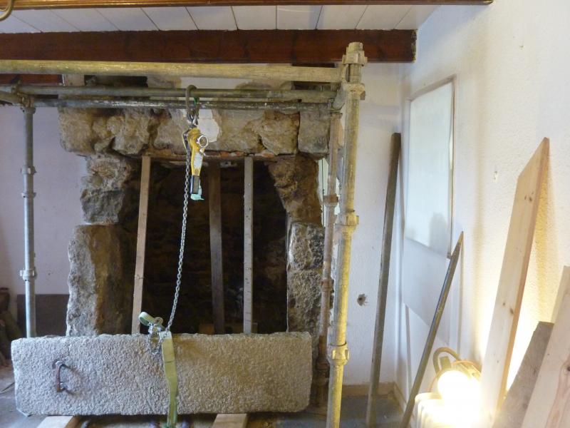

... We have found a Lintel with the right dimensions and colour granite to replace the original it’s just a little long ... So this is where we are now ...
:D

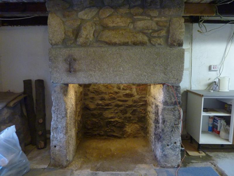

Update...

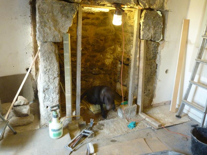

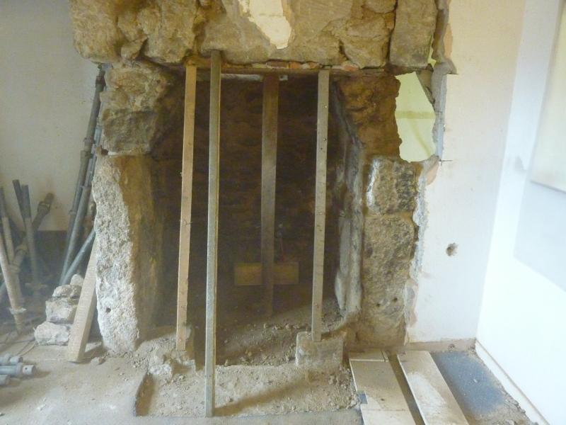

So we finally cleared all the inside
Took out the old lintel ends
Constructed a lifting frame
Positioned new lintel

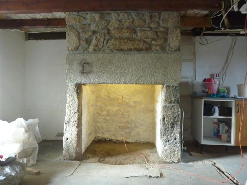

And this is where we are ...
... next up – slate hearth and wood burner

Thank you – The hardest part was not knowing what remained above ... but yes it has been great to get everything back to basics.
Wood has been stored and we have purchased a Morso Squirrel which should be the ideal size and doesn’t require any extra air vents.

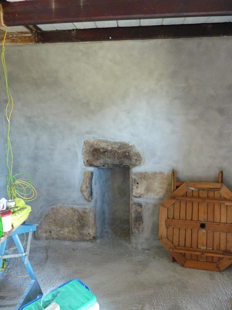

This little beauty was hidden behind layers of artex and plaster in the kitchen … So we couldn’t resist exposing it further …
I assume the apparent wooden plugged drill holes may have held the front of a small Cornish range? … not worth keeping the plaster around it so decided to start fresh …
… and due to its depth and position in the now dining area, were now planning to convert it to hold a decent wine rack! … job done! Now back to the inglenook

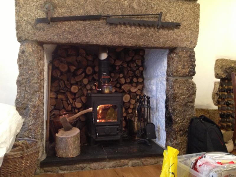

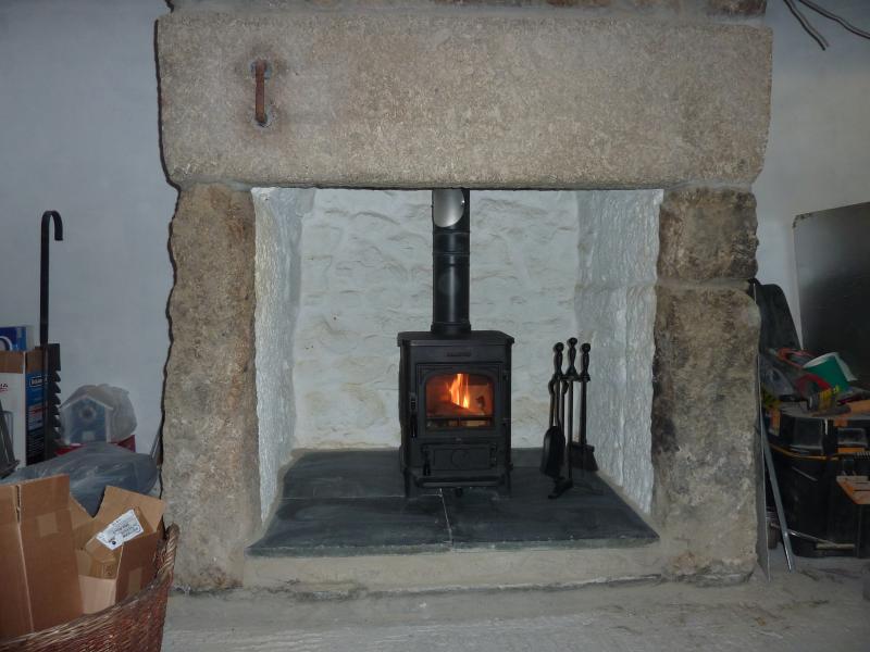

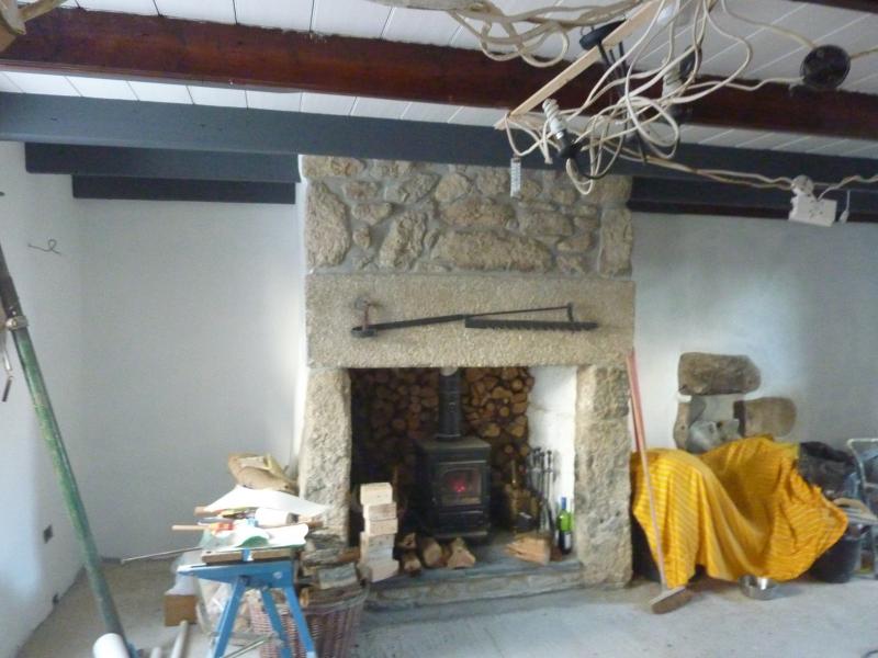

Richard you will be happy to know that we have our metal plaque and certificate for our little stove … and it kept us very warm throughout winter …

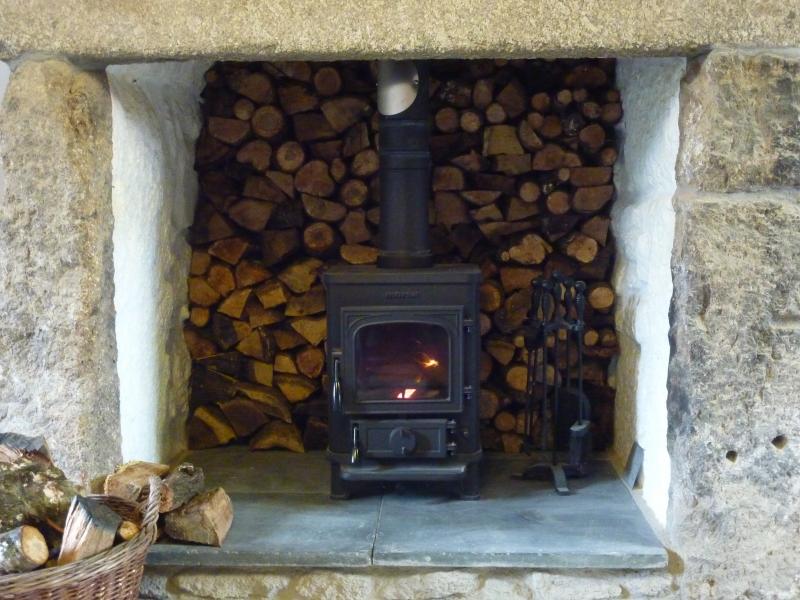

Due to the inglenooks depth we have taken to storing wood behind the stove … we have been assured there is more than enough room not to have to worry about combustion and it helps to keep the wood nicely seasoned …
The last pic (sorry again a little blurry) shows the little fire in relation to the inglenook … were now putting down the oak floor …
Thank you for your comments misterhill – I’d be happy to pass on the little I know … as for the soot – we used a couple of coats of ‘Polycell One Coat Stain Stop’ http://www.polycell.co.uk/products/polycell_one_coat_stain_stop.jsp ... But saying that it could probably do with another … good luck !
Hi - They are roughly 300mm back from the stove but the stove also has a heat deflector (came with the stove) to its rear ... the logs have been there for a year and haven't shown any sign of combusting :)
