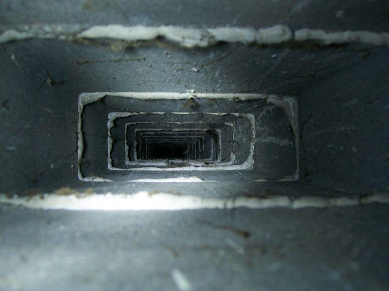

Anyway, when these properties were built, there is a flue built into the wall using precast blocks. I didn't realise this until I had the electric fire out in the flat to get the model off the back (needed new elements) and happened to look up. Needless to say, at every joint is a big bead of mortar that the bricky couldn't be a**ed to wipe off :roll:

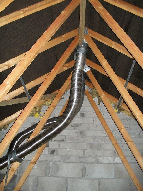

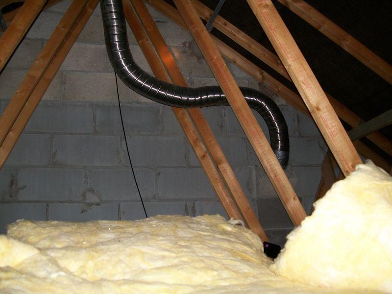

In the attic, there is a piece of flexible flue linking a pipe sticking out of the wall to a ridge terminal. For the flat, there are two in the same attic - meaning my flue can't be inspected/worked on without going though the flat above.
I especially like the way one of them is gaffer taped to the timber - so no clearance from combustibles there :shock:

Did not read your entire post but flexi flue liner is only suitable for lining flues not to be used as per your photos in the loft ! bodge up !
Need to replace that with b vent or something, should be clamped and supported, liner is for lining...

Innapropriate use of a flue material.Unlagged,not supported,wrong transition piece,and that mortar in the flue blocks.....need I go on.An absolute abomination. :shock:

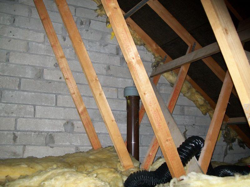

Errr, now I come to think about it, that's not as good as it sounds, because I believe the draughts are coming down out of the attic. There is a soil pipe runs down from the attic (are air admittance valves allowed in attics - unlagged ?) through the corner of his kitchen with branches for his kitchen sink and bathroom, then down through my kitchen with branches for kitchen sink and bathroom. He used to complain about smells from my tenants (either strong cooking smells or ciggy smoke) but some expanding foam into the boxing in at my ceiling height seems to have cured that. I suspect his draught is from the attic, down the box round the soil pipe, out behind the kitchen units, and then out through all the gaps into the kitchen.

Lastly, what about the two flues going through the attic of one flat ? Fixing that would be a lot harder as it would mean taking blocks out of the wall and turning the adapter round so it points through the cavity wall into an accessible space above the stairwell.
In my opinion, both flues are ID and Riddor, and thats how they would be treated.

Flues are unbelievable, I would be going ID due to the multiple AR situations (transitions, flexi, support, rise etc etc). It looks like a mock up in a training centre where tou have to identify all the faults.
