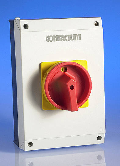

The good news is I am getting a spark in to replace my existing consumer unit to a modern unit and replace the existing cooker (including the rewiring) with this new cooker. I assume from your previous comments that I will need a cooker switch with a 50amp rating ? I had a quick look on tlc-direct but they're all 45amp - any suggestions where I could pick one up.
Ade B
TLC do this (63A):
But it's not very domesticated :wink:
But your sparky will be able to source one - they do exist - I know that Crabtree make one, for example.
