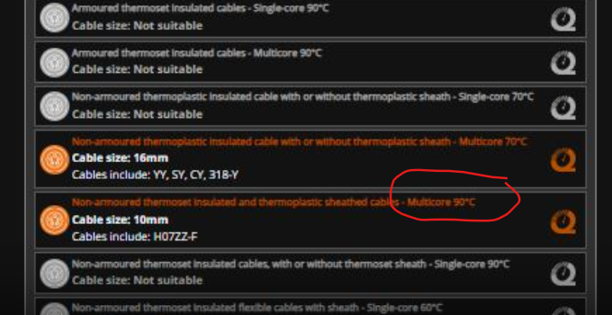

At the minute I use 12m of 6mm2 twin/earth cable (going through insulated joists) starting with a B32 RCBO going to a 45A DP switch which then goes to a 45A cooker outlet which is behind the existing gas hob/electric oven cooker.
I'm looking to future proof for an all electric cooker (electric oven/electric hob). To do this I have already threaded about 10m of 10mm2 twin/earth cable through insulated joists. I will pay an electrician later on to connect the 10mm2 to a B45 RCBO. The 10mm2 cable is about 2m too short to reach the cooker outlet position so I will need to use a 60A junction box (1) located under the floorboards (at half joist depth so 100mm deep), then the 10mm2 cable goes to a 45A DP 1 gang switch (2) (with a 25mm backbox (2.1)) then to a 45A cooker outlet (3)

I think it's this 45A fixation which is the root of many of your problems. I'd say try using a lower number in your calculator, but it's probably too late.
