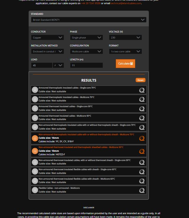

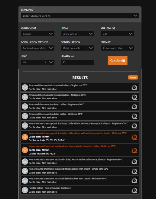

Have you allowed for the insulation when doing your cable calculations?
12m long, all within insulation, 10mm2, B45 RCBO, 45A DP switch. Electric calculation (see JPEG) says 10mm2 for 45A is fine

But you have selected in conduit, not enclosed in insulation!
It's Reference Method 101 = Above a plasterboard ceiling covered by thermal insulation EXCEEDING 100mm.
I ran, in that calculator (https://www.elandcables.com/cable-calculator), every installation method available and the thickest cable needed for 11m, multicore cable, 1 x 2 core cable, copper, single phase, 230v, 45A.. is 10mm2.
IF that is the case then the maximum current for 10mm² is 36A. Hence my last post.
Don't you mean thinnest cable needed?
Once again - it won't be 45A load.
Yes, I meant thinnest cable so 10mm2. What's the most powerful all electric cooker running hob and stove all at once?

Nothing you can normally buy for domestic premises will require more than a 32A circuit.
Clipped direct or buried in masonry a 4mm² cable would be adequate.
