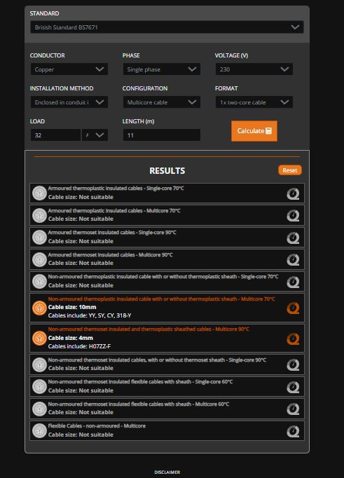

Saw thanks. Ok so 10mm2 is plenty even with insulation. Future proofed at least in case I end up having to use an all electric cooker.
10mm² yes, but not the type of cable you used.
Just put in a 32A RCBO then all is good despite your mistakes.
I used a Prysmian 6242Y Grey 10mm² Twin & Earth Cable. Says max operating temp is 70oC.
My DP switch has no socket outlet
That youtube video says "first 10A of rated current plus 30% of remainder"
So say I use a 32A RCBO. Then if I use a 12 kW electric cooker (12,000W / 230V = 52.1 A. So using diversity it's 10 A + (52.1 - 10A)x 30% = 10 A +12.63 = 22.63A.
I could use a 14kW electric cooker (14,000/230V = 60.8A, diversity it's 10A + ((60.8 - 10A)x30%) = 10 + 15.24 = 25.24A.
16kW electric cooker (16,000 /230V = 69.5A, diversity it's 10A + ((69.5 - 10)x30%) = 10 + 17.86 = 27.86A
electric calc says a 70oC 10mm2 cable is fine with the worst case scenario (any option) of the installation method for a 32A load.
So in theory I can get up to 16kW electric cooker. Though 14kW more likely

20kW @ 240V is the maximum with 32A MCB/RCBO.
Yes, but you must use a 32A MCB/RCBO
Well yes, either would be ok but, as above, 20kW @ 240V (19.167 @ 230V) is the maximum.

Not theory. It is all most dwellings have for the cooker circuit for some reason.

Or, as above, You could have used the original circuit for any cooking appliances you are likely to get in the future.
I think that , by now, you might have started to envisage that you could use the existing cooker circuit for that total load after applying diversity and therefore not actually use any other cable or any other circuit and it would be very very unlikely to cause any foreseeable problems.
You might feel that using a 10.0 circuit loses less volt drop therefore less energy wasted in the cable and more for the actual cooker - only a tiny smidgeon even by smidgeon standards so is it really worth it?
You might even run one cable for part of that load and the other cable for the other part of the load, again an almost worthless smidgeon.
When considering the total load of the cooker circuit it might be one bog standard cooker design of an oven, an eye level grill and a 4 ringed hob.
It could even be separate appliances each a small distance apart , that does not changing the load circumstances as far as your calculation for total load and usage.
If it`s pretty standard-ish type of use for a standard domestic family of two adults and approx 2.4 children or thereabouts, that changes absolutely nothing either.
If you were running this all as say 4 cooking appliances in high usage for prolonged periods 24/7 then yes things might change some.
So, in the real world, do the simple calculations and keep things simple, do not waste time and money doing something with no realistic benefit.
