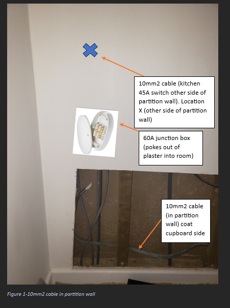

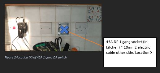

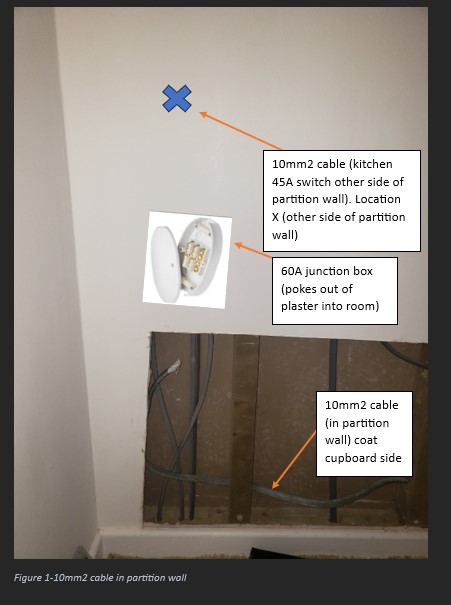

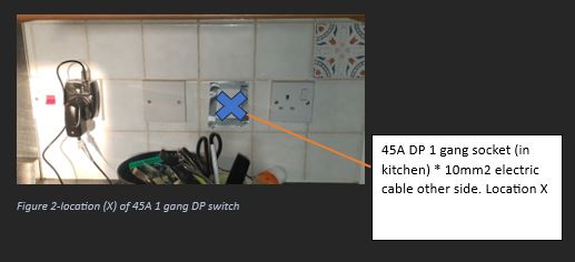

What about putting a 60a junction box about 1.2m high poking out of the other side of the partition wall to the 45A kitchen switch? So fully visible. The other partition wall is inside a coat cupboard so the junction box would be fully accessible (i.e not under floorboard). Then I can get 1m extra of 10m2 cable to go from the 60A junction box to the 45A DP switch. Here are some pics. The coat cupboard is 'coat coat cupboard switch'.

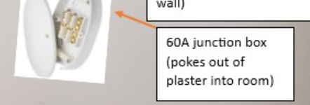

Ok what about (same reply to EFLImpudence) as putting a 60A junction box 1.2m high up on the shared kitchen wall inside the coat cupboard? Poking into the cupboard so fully accessible. Then I can get 1m 10mm2 extra to go from the 60A junction box to 1.2m high up on the wall where the 45A DP switch will go. See pics. 'Coat cupboard switch' shows where the 60A junction box goes (said junction box would be screwed to the 3"x2" vertical CLS timber.

This is all a bit naff for the cost of a bit of cable.
However -
Why not instead use a back box and blank plate with some ceramic connectors in it?
Then they will be accessible.

Yep exactly just thought of that. Thanks!
It's the labour (I would have to take down about 6 x plasterboard and pull about 200kg insulation out to then pull the 10mm2 cable through) - about a day's very dirty work - I hated it and would rather avoid.
So a 1 gang back box (47mm) and a 1 gang blank plate and 10mm2 ceramic connectors?

To be clear there are no wall sockets in the coat cupboard, but there are 2.5mm2 x 4 cables going vertically upward. So clearly the backbox should not be directly in front of these vertical cables. I can put the backbox at a height of 0.45m to 1.2m (these are current regs for sockets). What height should I put the backbox at?
There is no reason why it should not be.
If the cables attached to it go up and down, the height doesn't matter.
If one of the cables were horizontal, then at the level of the cable.

Those heights only apply in new build houses to comply with disabled access. Building Regs Part M.
It is not a requirement in existing dwellings. Put the back box wherever suits you, subject to any concealed cables being in the permitted zones.

The 10mm2 cable goes behind the cooker and vertically down from the 45A DP socket so should be fine
