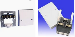

I'm looking to future proof for an all electric cooker (electric oven/electric hob). To do this I have already threaded about 10m of 10mm2 twin/earth cable through insulated joists. I will pay an electrician later on to connect the 10mm2 to a B45 RCBO. The 10mm2 cable is about 2m too short to reach the cooker outlet position so I will need to use a 60A junction box (1) located under the floorboards (at half joist depth so 100mm deep), then the 10mm2 cable goes to a 45A DP 1 gang switch (2) (with a 25mm backbox (2.1)) then to a 45A cooker outlet (3)
FGS why, oh why, oh why have you done that? What possible reason did you have for not using one piece of cable which was long enough?
I've read here that old-fashioned screw terminal junction boxes aren't allowed under floors any more,
However those boxes cannot be used in concealed locations, so are totally unsuitable for this application.
so your whole plan may crumble on contact with an electrician.

There is no 'maintenance free' 10mm2 junction box. Can I put the 45A DP switch inside a cupboard instead (this way the 10mm2 cable should reach without the need for a junction box)?

Have looked. There is no 10mm2 wago junction box. Can I put the 45A DP switch inside a cupboard?
I know, that's why I listed either a shrink sleeve or an epoxy resin type junction, and of course you will also need a set of crimp pliers and crimps for 10 mm². Yes, using a cooker outlet plate would work
but you still have a problem getting it signed off, so just let a scheme member electrician do it all, it will be cheaper that way.
I know, that's why I listed either a shrink sleeve or an epoxy resin type junction, and of course you will also need a set of crimp pliers and crimps for 10 mm². Yes, using a cooker outlet plate would work View attachment 389015but you still have a problem getting it signed off, so just let a scheme member electrician do it all, it will be cheaper that way.
