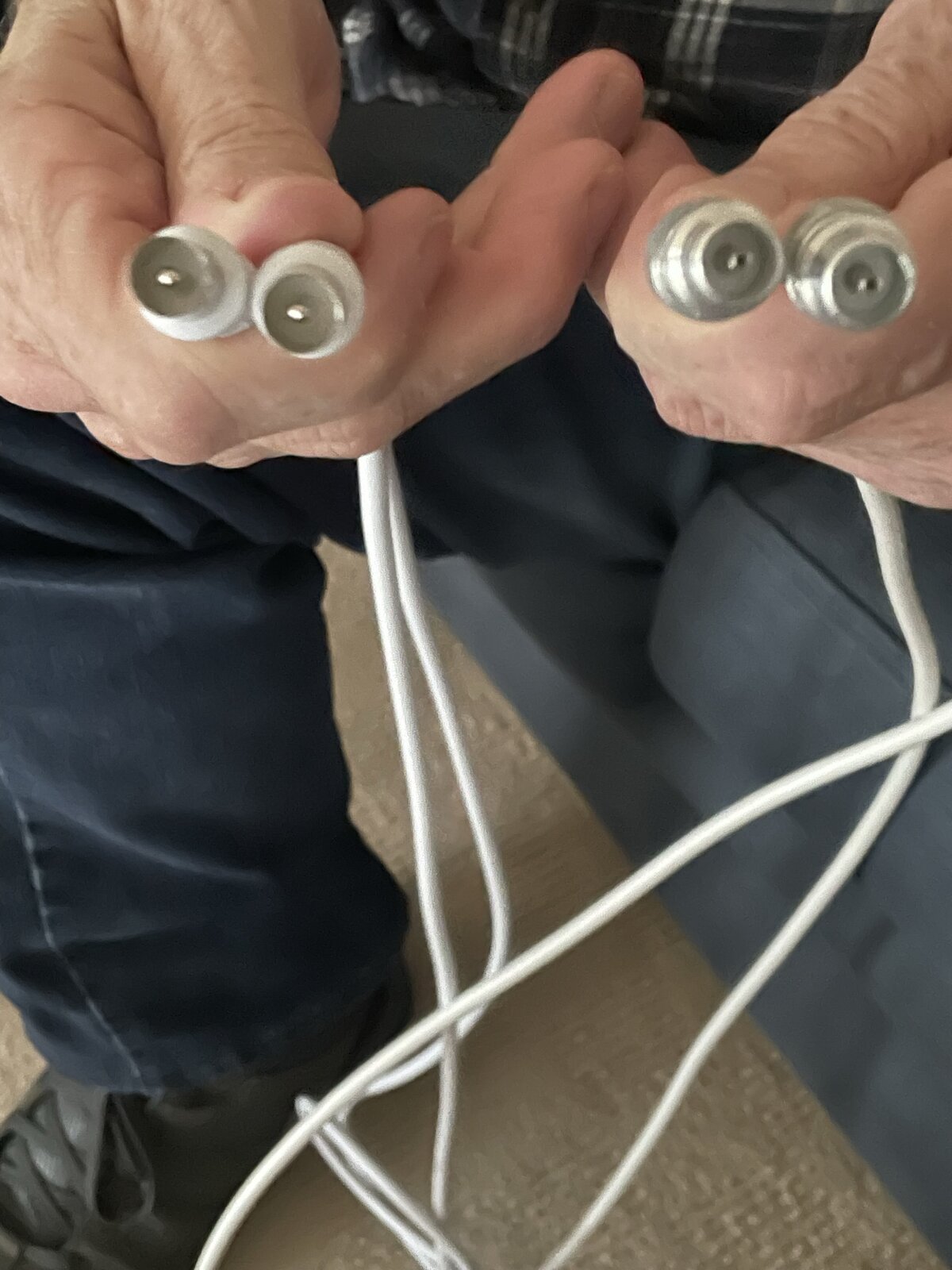

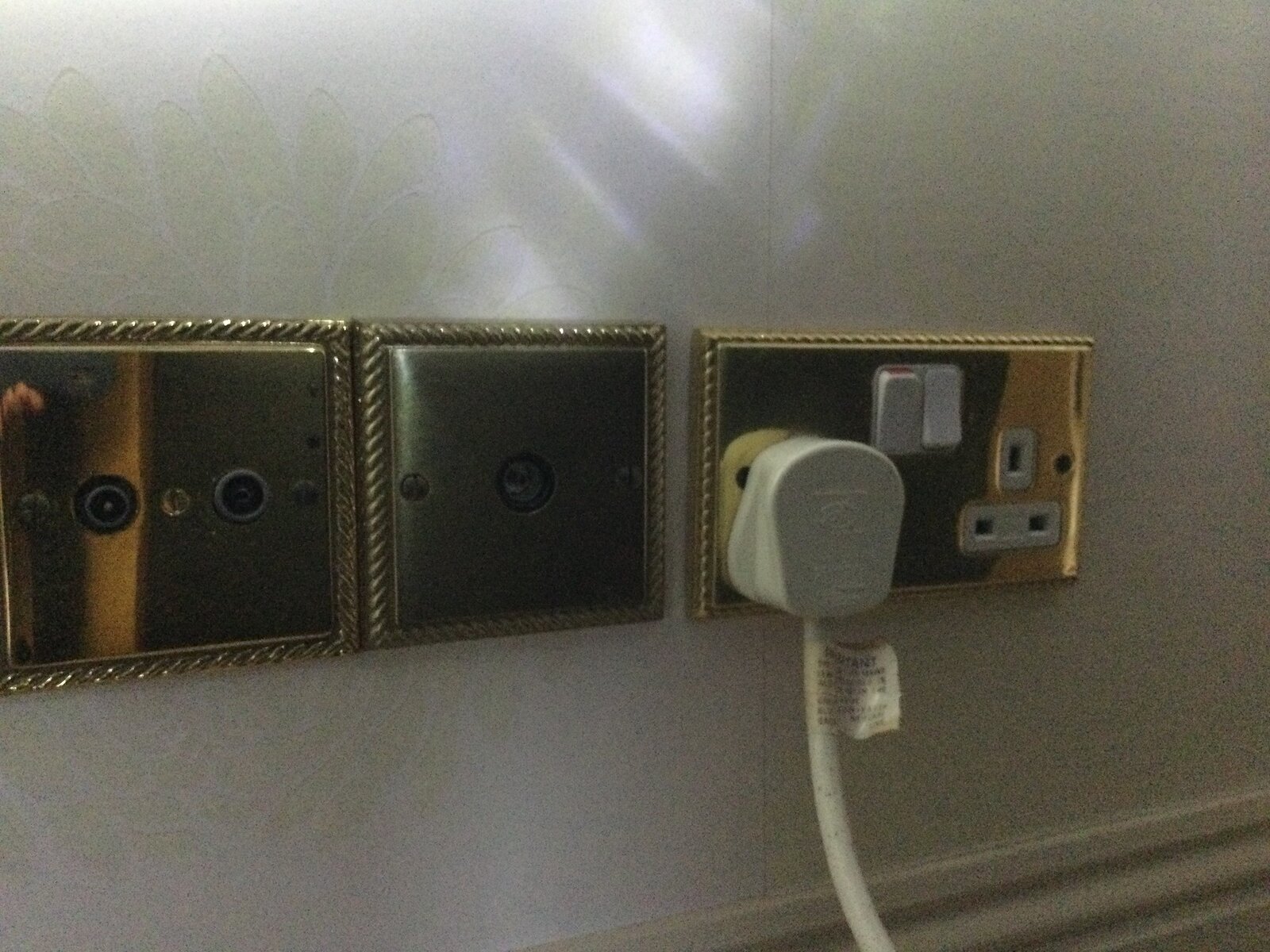

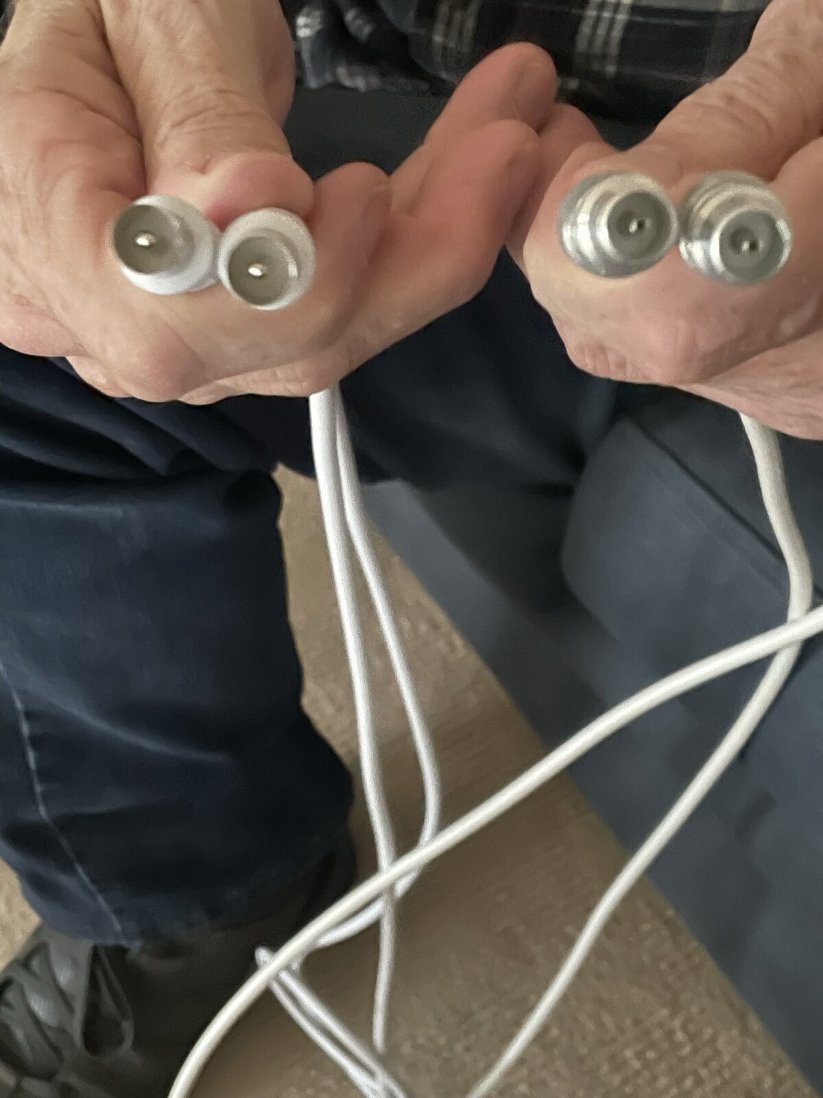

Hi again,
thanks for again trying to help ….
1 people here are quite elderly … we have been told of one resident has bought his own satellite system but that wouldn’t available to us. So I can only assume we have a ‘standard’ aerial which is in the roof space. Managing agent (newly appointed) doesn’t know
2 previous owner was an engineer and based on what we now know about him he knew what he was doing and not a bodger. (He died in the Spring of this year - so we can’t ask).
3 aerial lead swap seems to be the first thing to try
4 we have numerous aerial sockets throughout the property - but have found none with the screw in connection we used before we moved here last Thursday.
5 the first picture shows the ends of 2 aerial leads. The pair on the right belong to the lead which gave us 10 programmes. The pair on the left gave us no programmes. The ends are different. One set both male the other both female.
Without the screw in socket, I am obviously having to use a different lead to the used at the previous property.
Questions: do I have the correct type of aerial leads?
Am I using the appropriate aerial socket.
I have tried the single aerial socket - which gave us the 10 programmes - but is this the one I should be using?
Sorry to be so long winded but As I said before, I don’t really understand and it is very frustrating!
thanks in advance!

Just going down the points in order
1 - understood, but it doesn't help us so we'll move on
2 - encouraging (& RIP)
3 - pictures help greatly, thanks. See below
4 - you won't find the screw type. It looks like previous occupier installed an aerial distribution system rather than aerial and satellite. That's not a bad thing actually because Sat signal distribution doesn't work in the same way as aerial distribution. It simplifies things
5 - see below
Those brass faceplates, the one picture left with two sockets, that's a TV and Radio wall plate. I'm not going to deal with radio at this point other than to acknowledge that it's the type of plate. What you're missing (or at least appears missing from the photo) is the labelling on the sockets that tells you which signals out of what sockets.
The left-hand socket is the one for TV. The receptacle end on the wall plate is a male. That means you either need a cable that's female to male, or you need what's known as a gender changer - a back-to-back / cable joiner / coupler adapter - on a male to male lead.
The cables that you have both appear to be male-to-male. The plug ends picture left are the type used with moulded cables. The plug ends picture right appear to be the plug type you'd buy loose and use as a DIY fit to your own cable. I know it's got holes in the centre post ends but that's how they're made so that the centre core can poke through and be soldered in place. (Incidentally, the cable in both examples appears to be the thin and poorly shielded extension type sold by Argos / DIY sheds / supermarkets.)
If one of the cables is female to female then you'll be able to link the two together daisy-chain fashion, but I suspect they won't do (don't force them) because they're both male.
The immediate fix is a coax gender changer.

Those plugs are called 'Belling-Lee'. It could be that it was wired to allow the signal to be daisy-chained through to other rooms, rather than a distribution amplifier being used, so that every room can have a TV. The female plugs seem to suggest this might have been what was done.
Do you have access to a multimeter, to enable you to trace which cables go where?
Aha! The issue seemed to be the need for a gender (?) converter - because I now have more programs than I could possibly watch including Talking Pictures!
