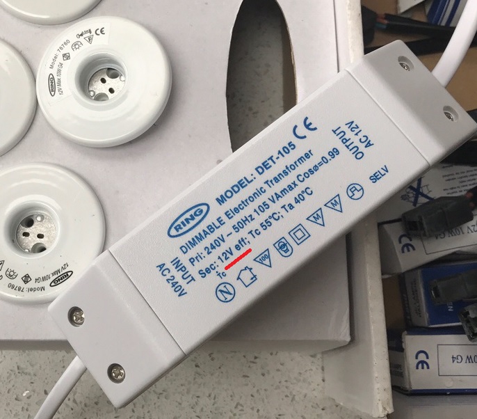

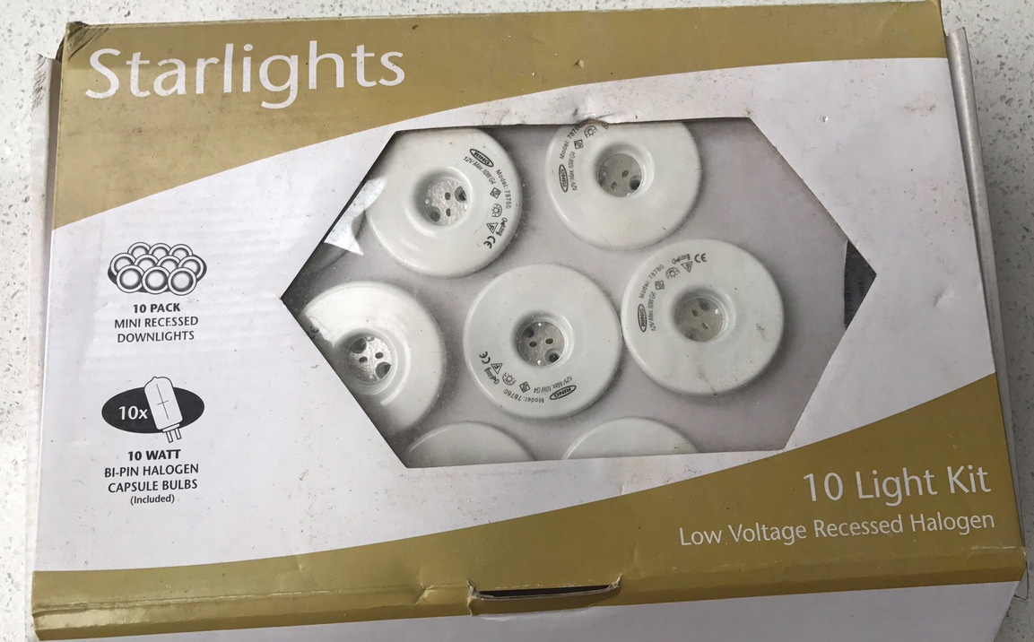

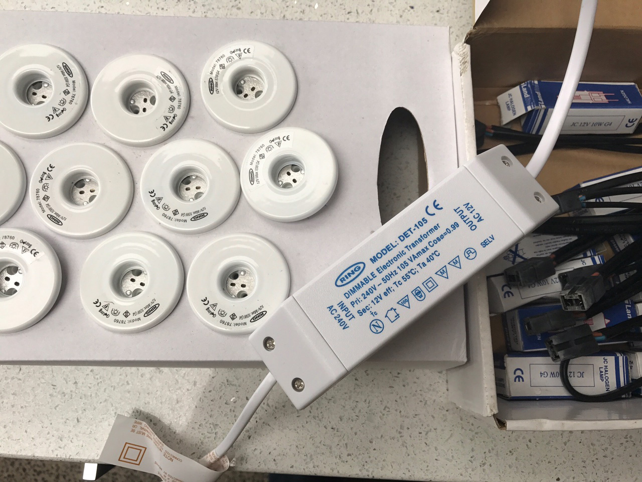

    See attached pics, it's the usual type of transformer I'm used to seeing with light TBH...?
    Now you mention the dimmer 'switch' load, I wanted to actually have the lights working off of an existing dimmer switch which has a ceiling pendant (breakfast bar light with 5x 40w G9's – the star lights were to form a circle around the main light)... so is that not advisable then?

    Most dimmers should work with that electronic transformer. Give it a try.

    Terminology is important here. Low voltage generally refers to above 50 volts. Your lamps are probably 12 volts which is generally referred to as extra low voltage. You really need to tell us the voltage as low voltage is meaningless.
    What you refer to as a transformer is almost certainly a switch mode power supply. If they say not advisable to use with a dimmer don't do so.

    His "obsession" is more a case of pointing out that refering to a switched mode power supply ( SMPS ) as a transformer can give rise to problems if the person installing the SMPS is under the impression that the SMPS will operate in the same way as an inductive ( non electronic ) transformer. Hint : radio frequency radiation.
    Just what is the AC frequency of the AC output of this SMPS ? And what does the eff in Sec:12V eff: mean ?
