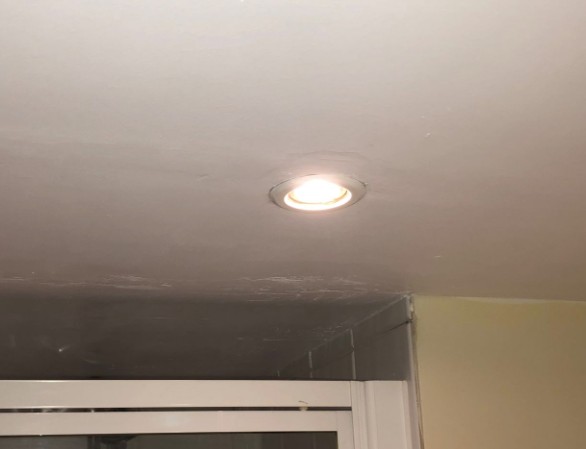

12V spotlight for bathroom

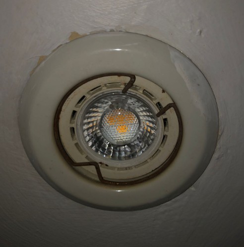

The issue with both of these is that they are INTEGRATED fittings. That means that if (when) they fail you have to throw the whole thing away and buy a whole new one. Better to buy downlights that use GU10 LED lamps, then its only the lamp that needs to be changed when it goes *PING*.
First thing also to check is the hole size in the ceiling. Buy one that fits the hole, or you're in for extra work.
