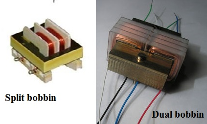

My way of think is that SELV ( Safe or Separated ELV ) can only be ensured by use of a transformer with either a split bobbin or dual bobbins
