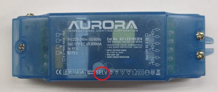

The problem I had when looking, was that there was no confirmation of SELV apart from some constant current supplies, but I did not want CC!
So really the suppliers should be a little more proactive and clarify if the item is specified as a SELV unit or not.
I obviously don't know which ones you've been looking at but, as an example (since I have several around), the Aurora DC constant-voltage LED supplies all seem to be explicitly marked as SELV ...
This one is only 800mA (at 12V DC), hence only 9.6W, but they do much bigger ones - which, I imagine, would also be marked as SELV - and you won't find much better a make than Aurora.

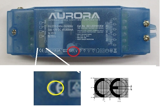

I seriously don't think anyone can draw any conclusions about the detailed shaped of a printed icon. The intention is clear. And they have a presence in Europe.
The C E mark looks dubious. Maybe the other marks are just as "optimistic"
Good grief - oh ye of little faith!!
As I said, I think one would struggle to find a more reputable and respected global company than Aurora, so I seriously doubt that they are in the business of faking 'CE' marks! If you don't trust Aurora, which (if any) company would you trust?!
In any event, as you are aware, the CE mark (however printed), per se, is not really all that relevant, since it merely indicates self-declared conformity with relevant European Standards.
Kind Regards, John
Quite so. ... and I think that "a presence in Europe" is a bit of an understatement. As far as I am aware, they have a very significant 'presence' in most significantly-populated continents and, if I recall correctly, I think their Head Office is in the UK.
... and, as we've both said, and despite the fact that some people seem to get excited about it, I don't really think that the shape of the CE mark is "either here or there". Quite apart from everything else, one imagines that a competent 'deliberate faker' would be more than capable of reproducing the mark/logo 'perfectly', to the satisfaction of bernard (and others)!!
So, why is a competent genuine manufacturer not capable of reproducing it perfectly?
Well, they obviously could/should be. However, assuming that they are confident that the product is CE-conformant (and could produce their declaration certificates if requested), maybe they are not particularly fussed about the shape of their CE mark? A bit 'lazy', perhaps, but maybe they don't even realise that some people get excited about its precise appearance - after all, I've never seen or heard anyone complaining/commenting on the (perfect or otherwise) shape etc. of any other symbol which appears on electrical items, have you?
