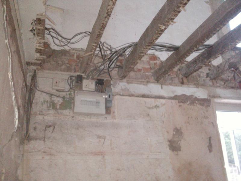

Hello all, need some info about what the 17th edition regs have added to the 16th edition as I am about to re-wire a whole house.
I re-wired my own house to full regs and got it signed off but don't know about what 17th edition says about RCBO's.
I will be fitting out with a split load cb with each side having it's own 63A 30mA RCD's with one side protected with a RCBO.
I take it the side with the RCBO has to protect the high risk areas such as bathroom areas and its lighting.
As both these circuits will be upstairs this poses no problem but...outside lights and kitchen??; do these areas and their circuits require an RCBO also.

So..call me stupid (please feel free), do I actually require a cb with RCBO's covering all circuits or is this overkill and where did the earth rod go in all this.
Is it now defunct or 'an also' because the regs also state that you should design a system that will not trip out on a regular enough basis to become a nuisance.
After all this can begin I know that I will have to inform the building control board from my local area, but I do not wish to fall flat on my face on day one over something silly.
Please can anyone help me out with this
