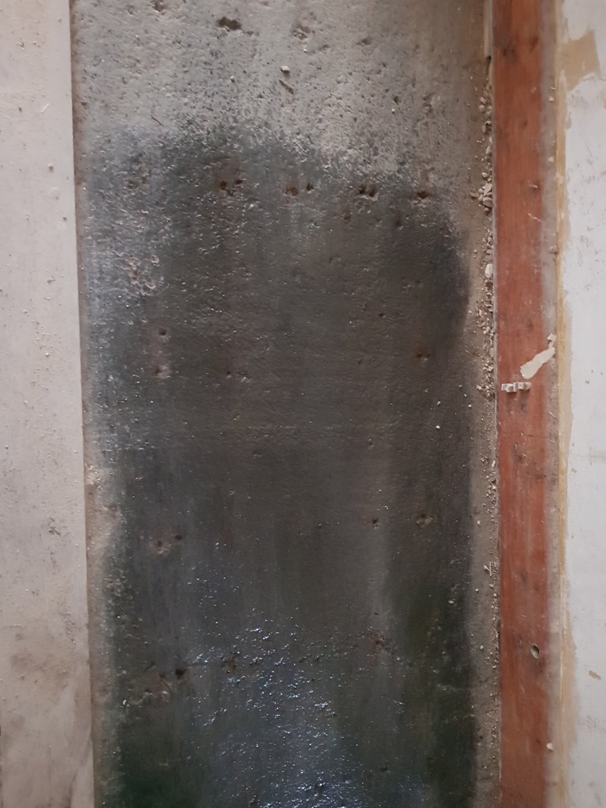

Hi,
Just removed my old T&G plank and at the beginning I though that below I had a very strong Concrete flooring but this is not the case.
I made few trial hole and the drill bits goes in like a soft cream and what come out is a black soil.
the all flooring does not sound very strong and my question is how I deal with that and if this is normal on old houses.

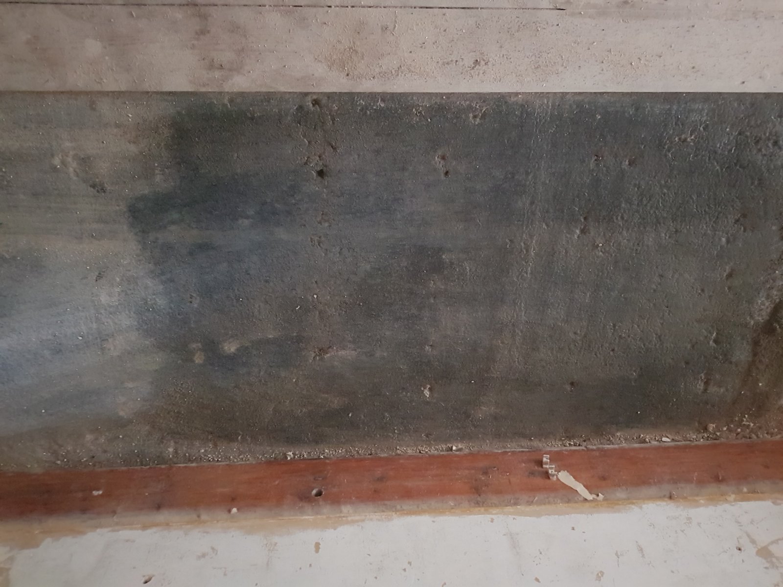

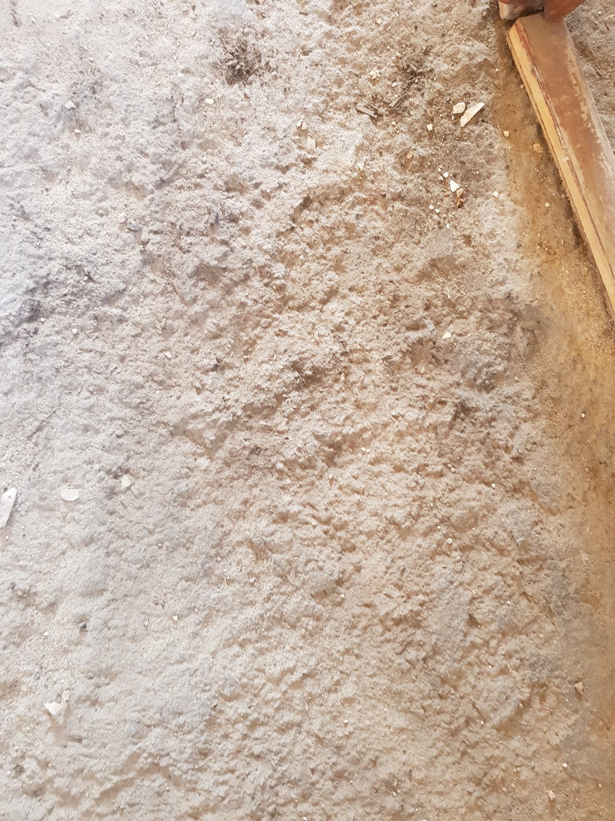

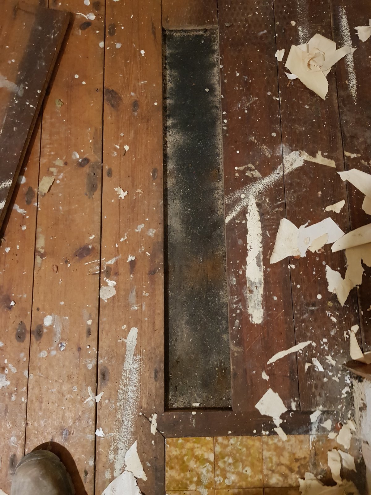

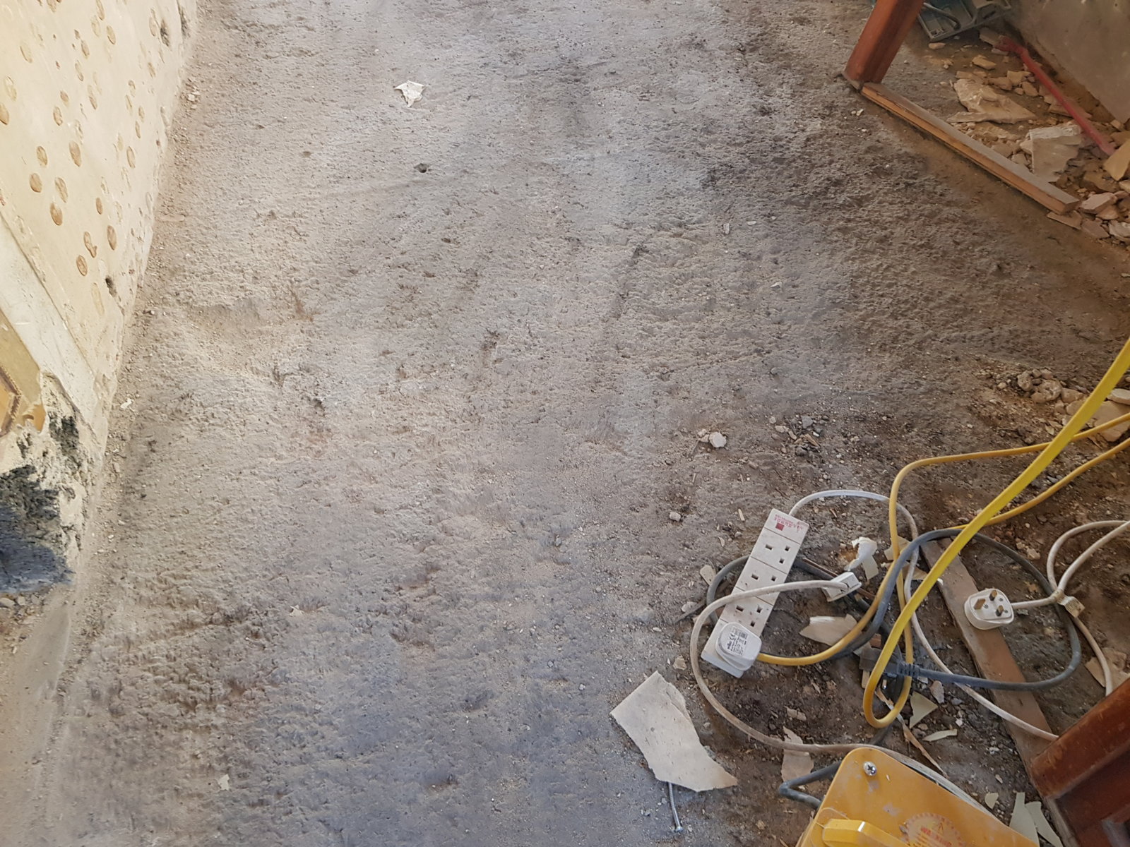

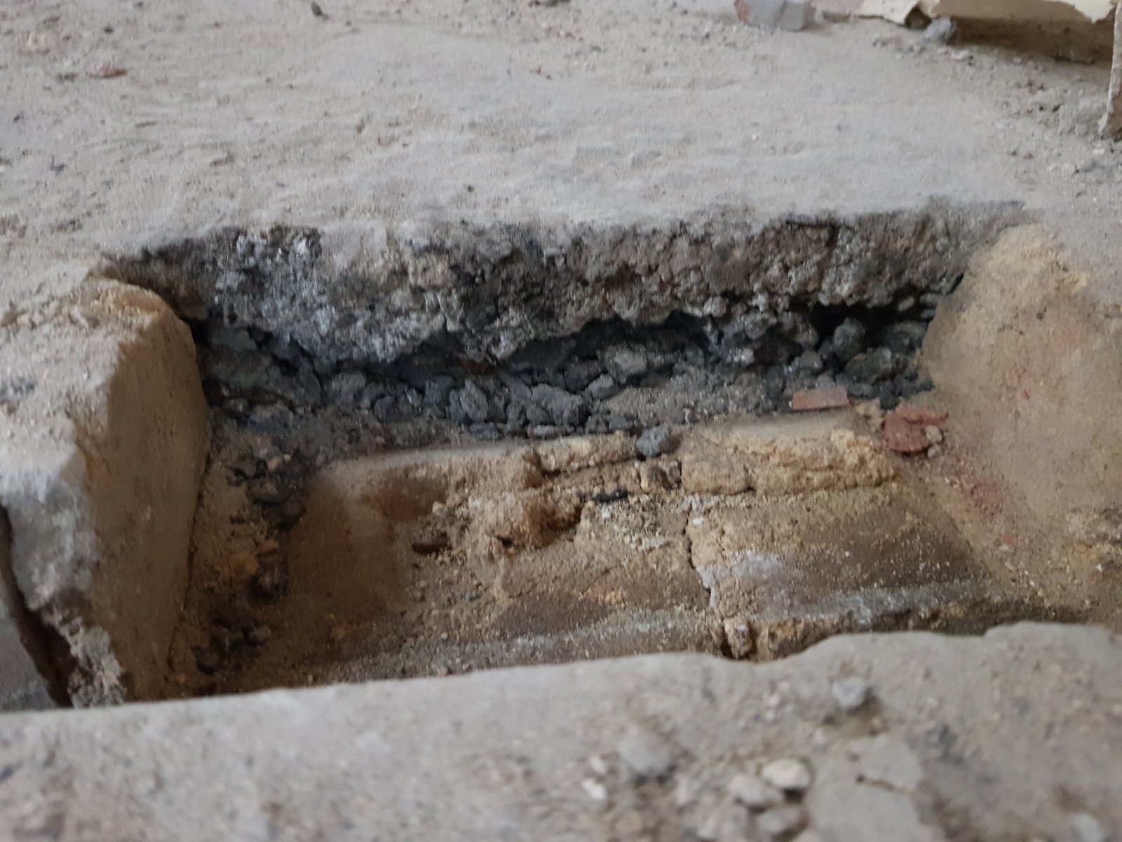

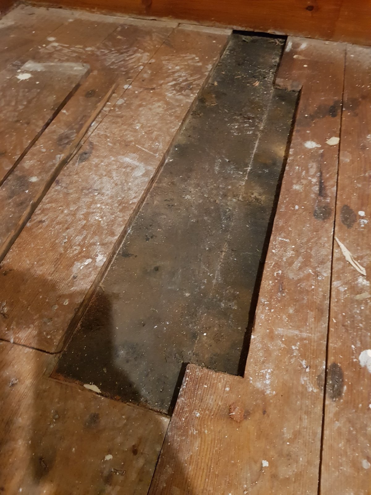

Tomorrow will post some photos. How thick is I have no idea yet. I drilled with a 10mm drill bits for 120mm and was the same thing as something like black powder. I have attached photos I have at moment on the phone but will make more as I will be removing all flooring.

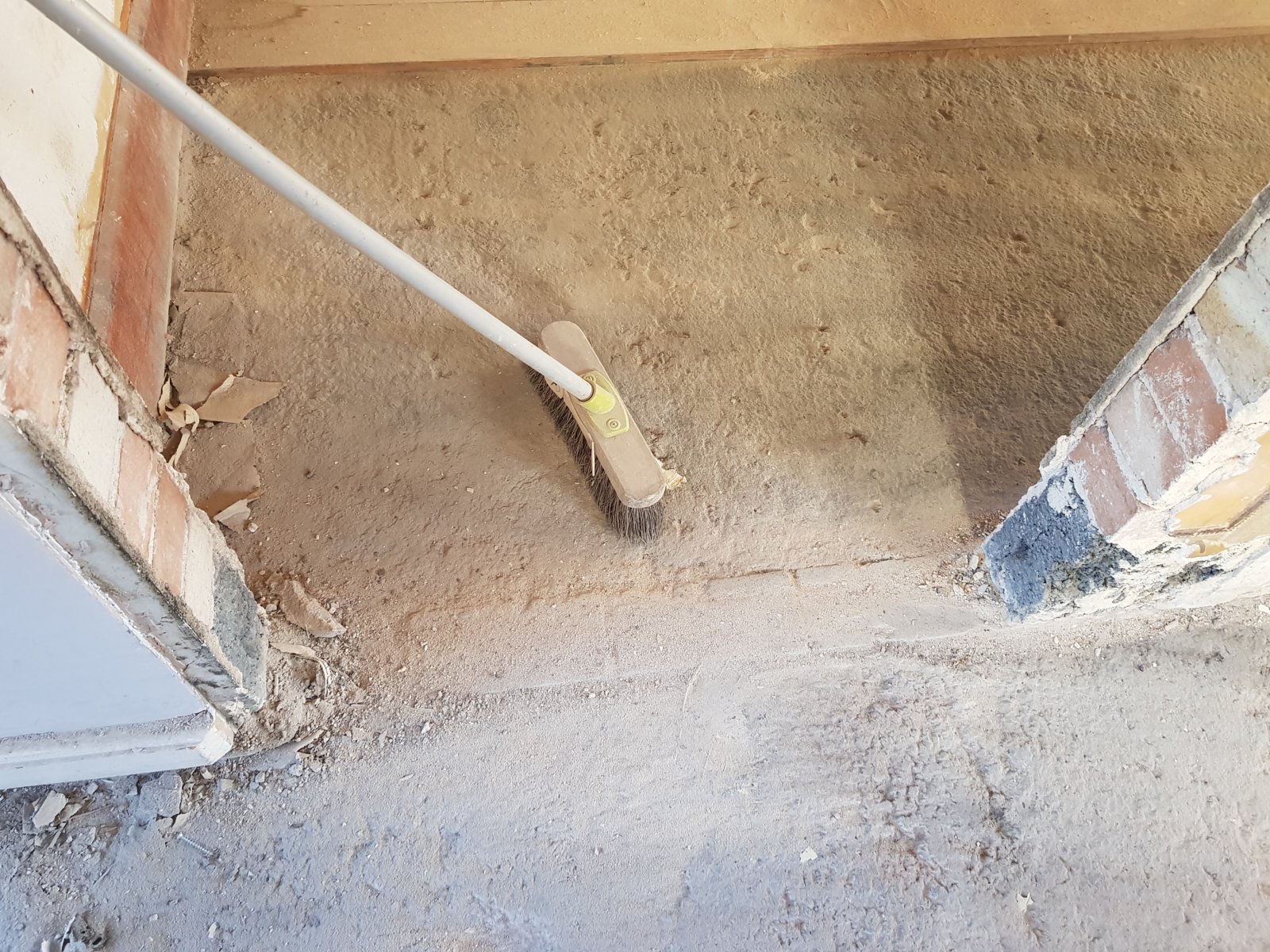

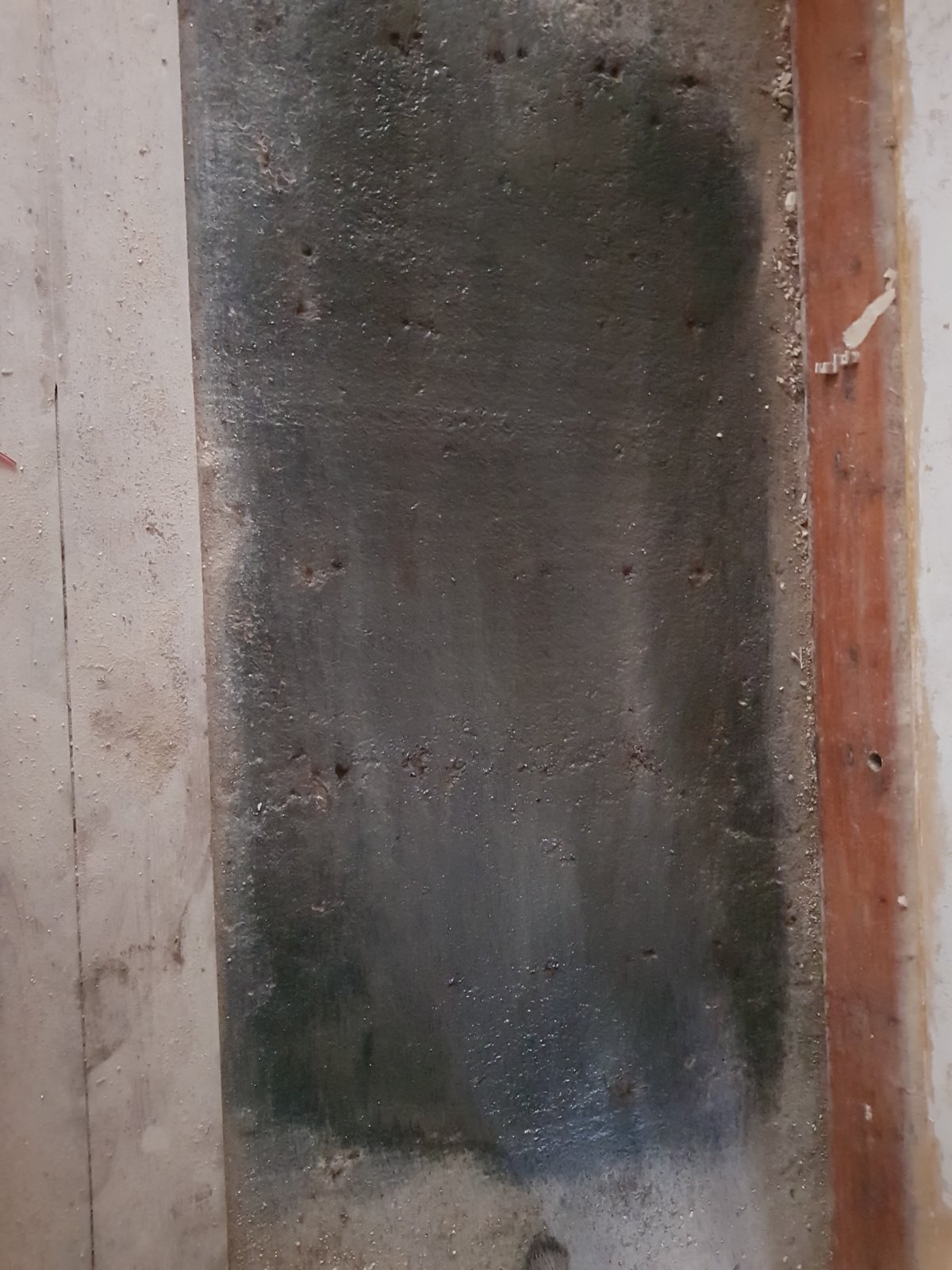

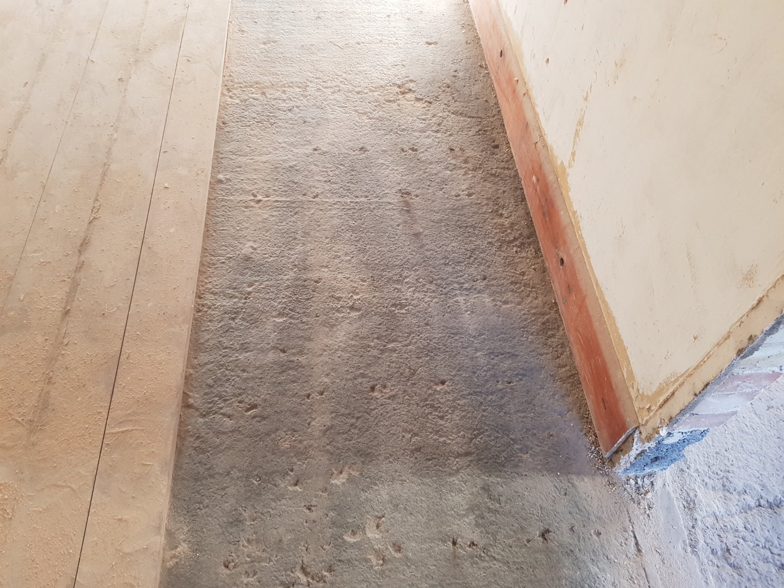

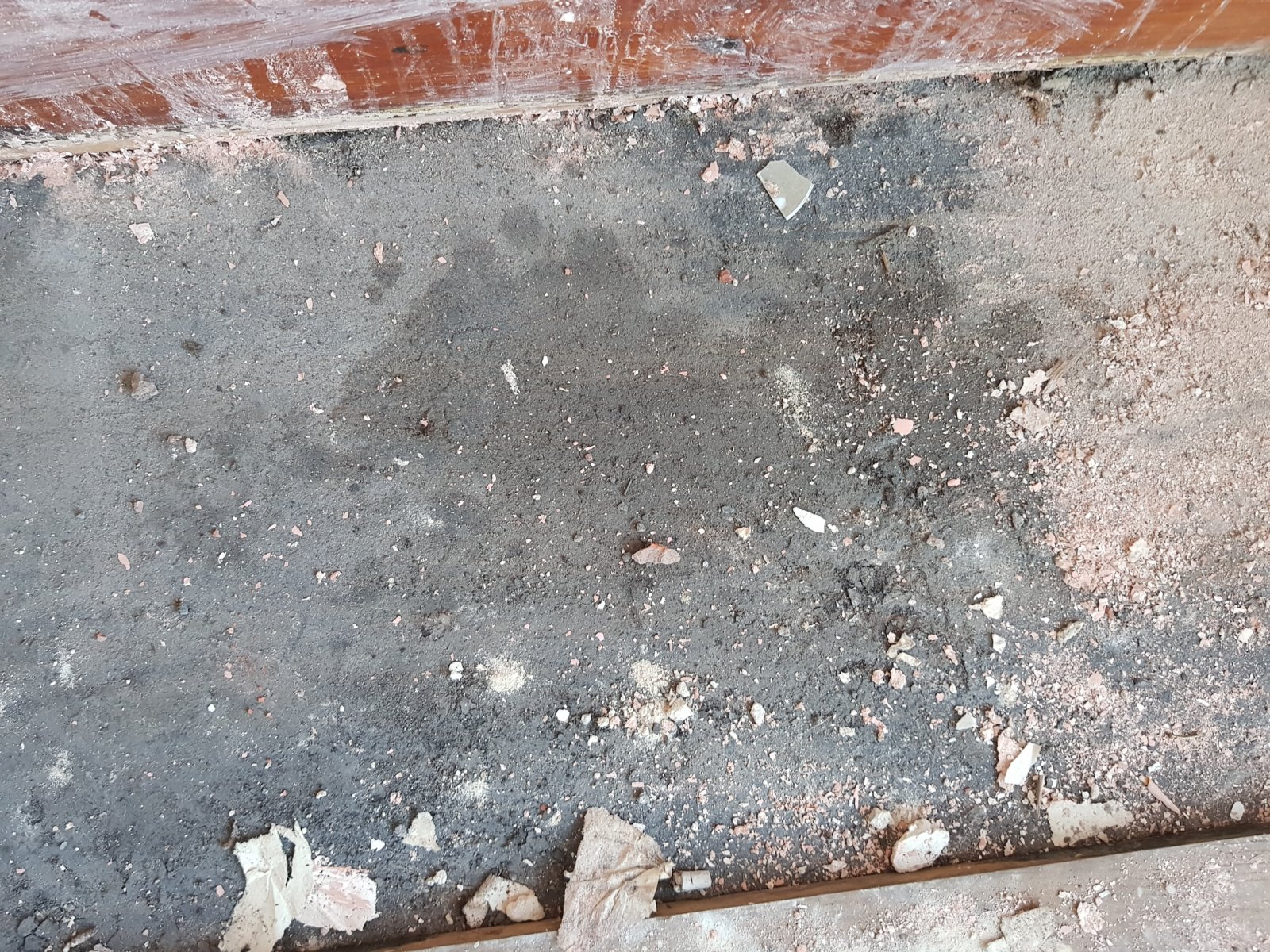

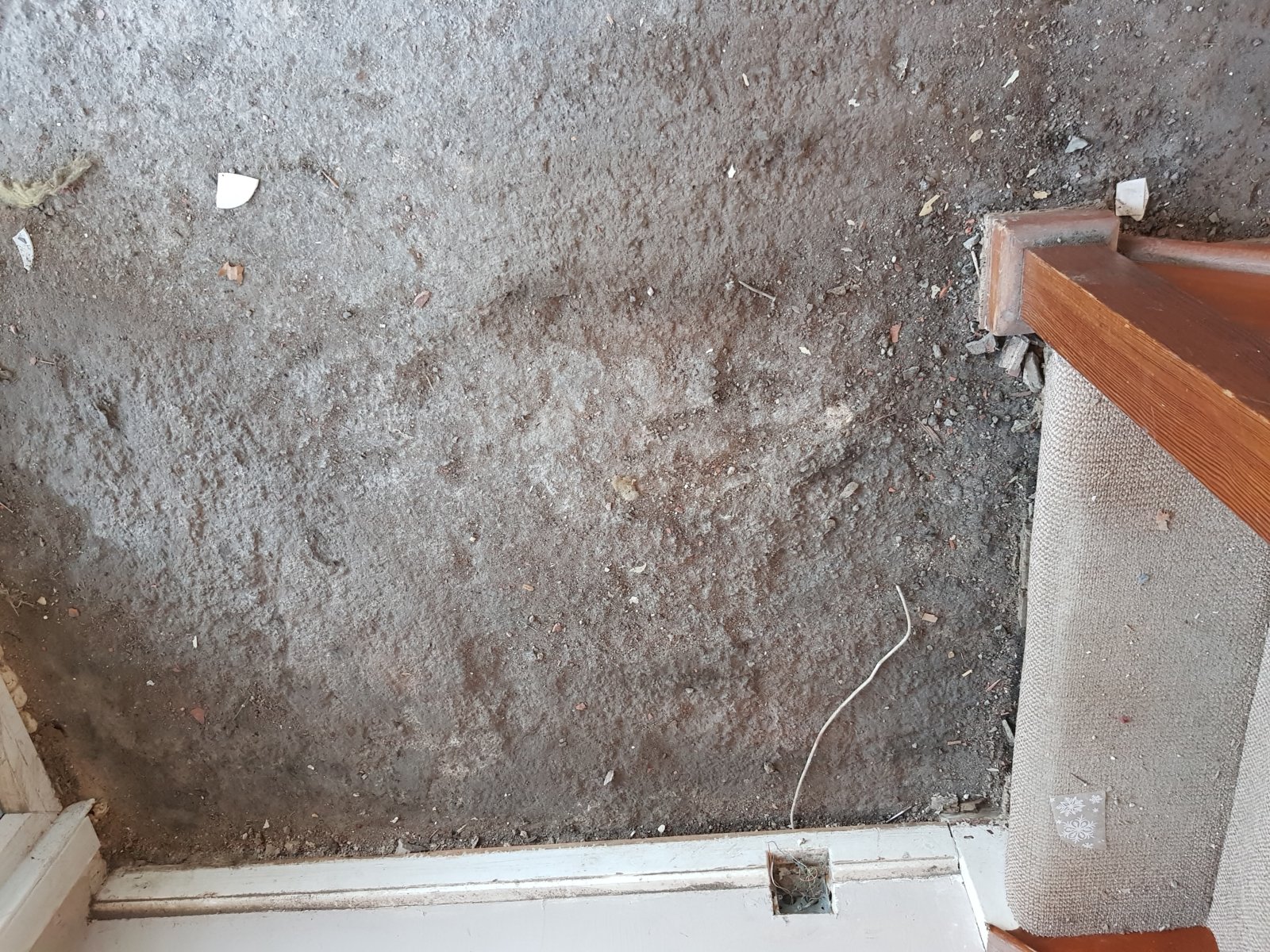

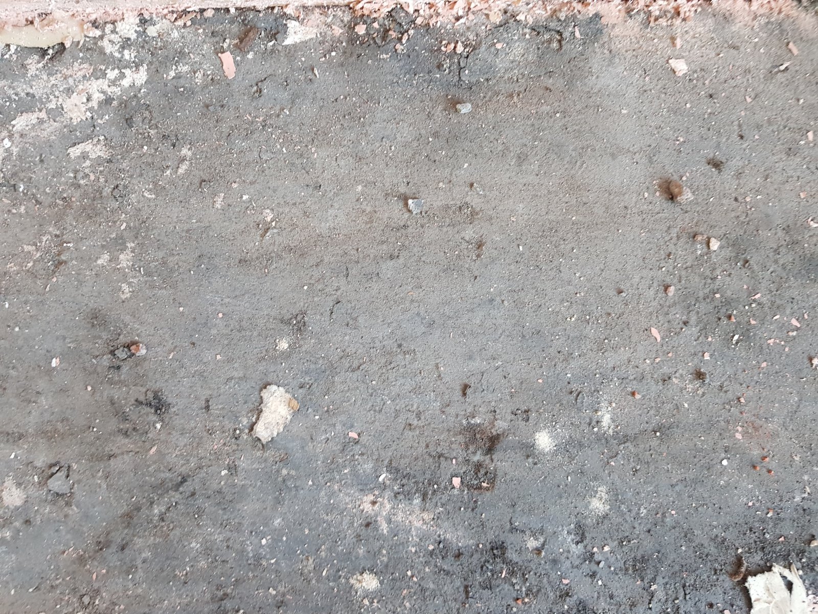

Here you go more photos

Thanks for the pics.
The latest pics show, so it seems, a different composition of floor material?
Maybe its the light or something but the first pics showed a say "bitumen" mix and the latest pics seem to show a weak cementitious mix?
Were the boards in the first pics damp - were there any white salts on the back of the boards?

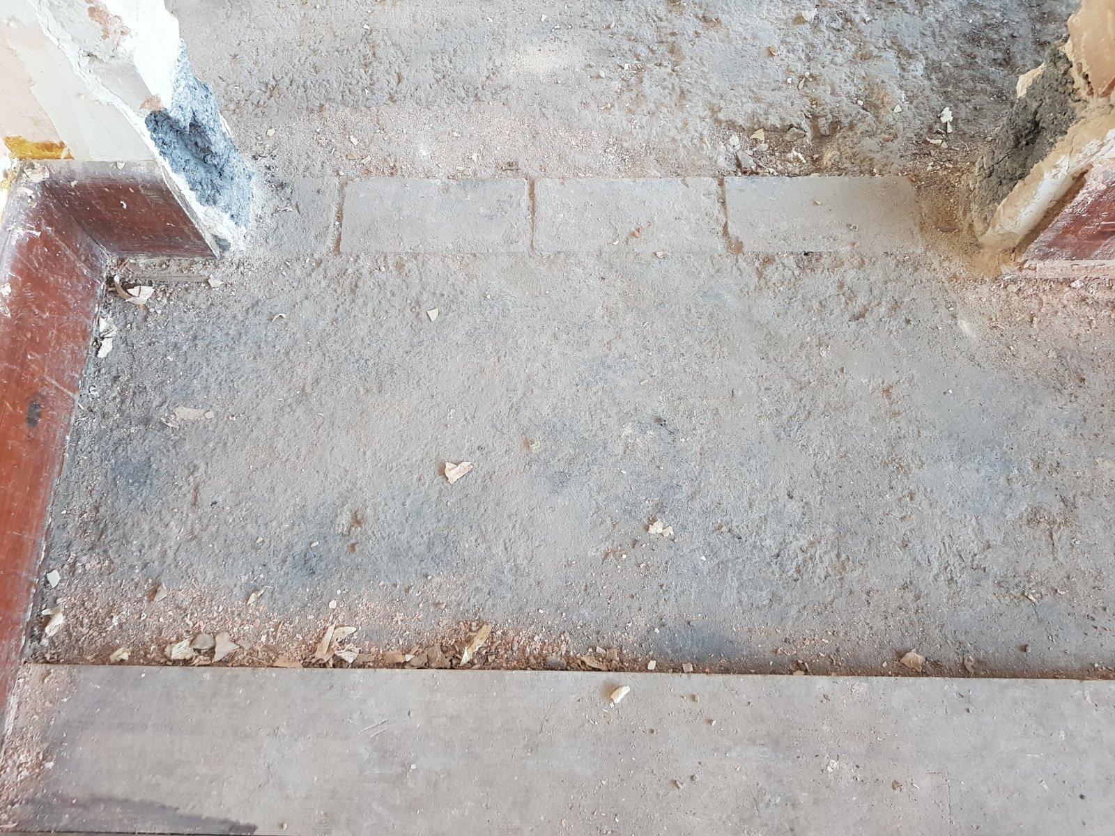

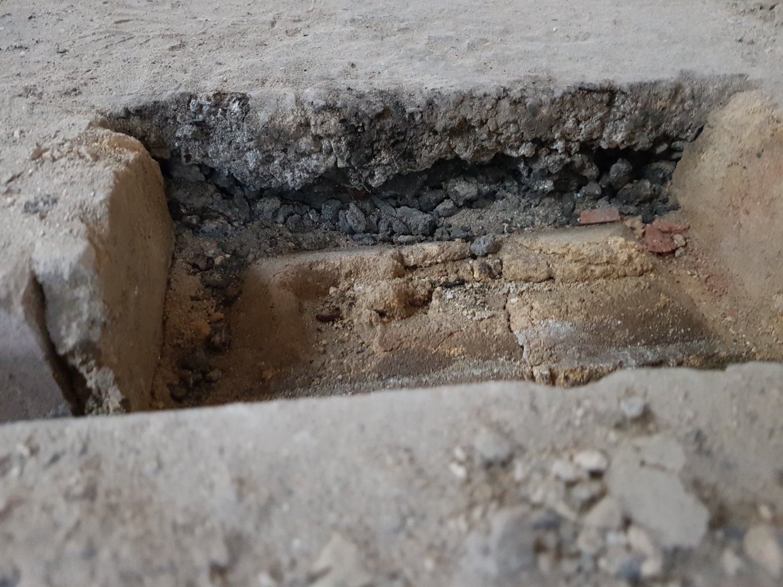

Except for pic 6, the floors in the latest pics look to be dry, & so do the walls. Is pic 6 a spill?
What kind of finish flooring do you want?
Hi, Phone battery died and could not make another photo where I removed a brick between the extension side and you can see a thick granulate solid in black colour.
I will upload it tomorrow.
Most of the photos are a little bit lighter and there is a lot of dust that covers or made the black to become lighter.
I will clean up with some water and upload more photos.
On the first photos there was a 18mm stone paving. No white salt on the back of the boards
Pic 6 is wet because I'm removing the wallpaper and this is a spill of water.
I'm thinking to install 18mm engineering wooden floor on 80% of this substrate and the rest (Kitchen) will install some tiles.
I was thinking to extend my hole pit to a 200/300mm to see what below. Just awaiting delivery of drill bits as all shops are currently closed. Is it worth it? I have also dug a trance for a drainage pipe on this flooring.
Walls and flooring seem to be dry and doesn't see any humidity at the moment. Do I have to check with some electronic tool?
On another note. In a few areas, the substrate seems to be a little bit weaker and sounds empty. My idea was to poor 3/4mm of latex or something stronger self-levelling room by room to make it sturdy but I'm here to get advice from you guys that have more experience.

It looks like an ashfelt floor to me, but not easy to tell as I can't see the whole area. I would leave it alone unless absolutely necessary.
