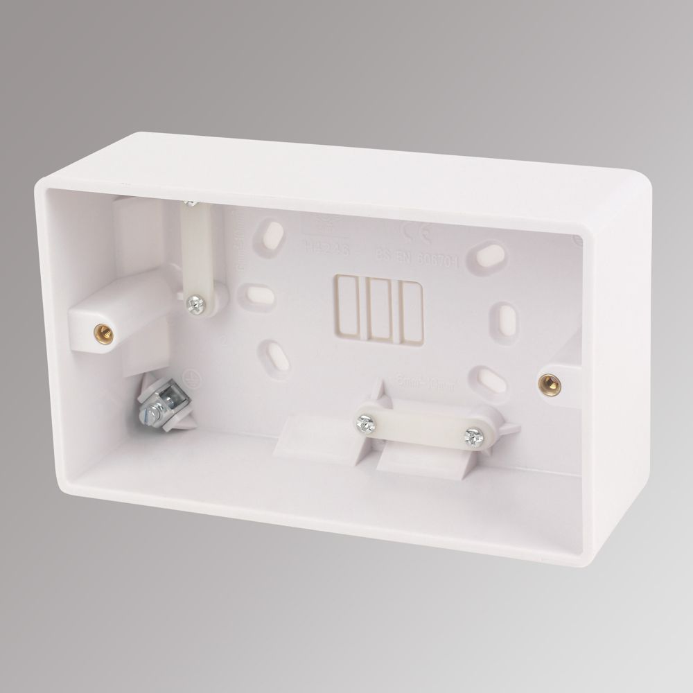

47mm box with cable grip, some shallower also available in some ranges

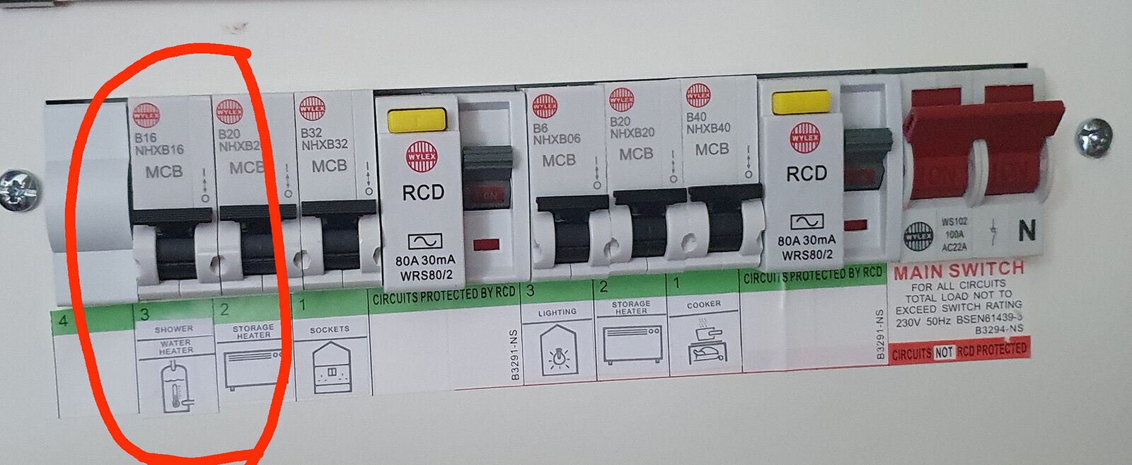

On which circuit are the immersion and pump?
A 15A/16A immersion heater circuit or the general 30A/32A socket circuit?
The immersion heater is on a dedicated circuit I am not sure what the A is of the circuit. I am not sure about the water pump but given that it is plugged into the same 2 gang socket as the immesion heater I imagine that it is on the same dedicated circuit as the immersion heater? Attached is an image of the fuse box with the dedicated circuit for the immersion heater ciricled.

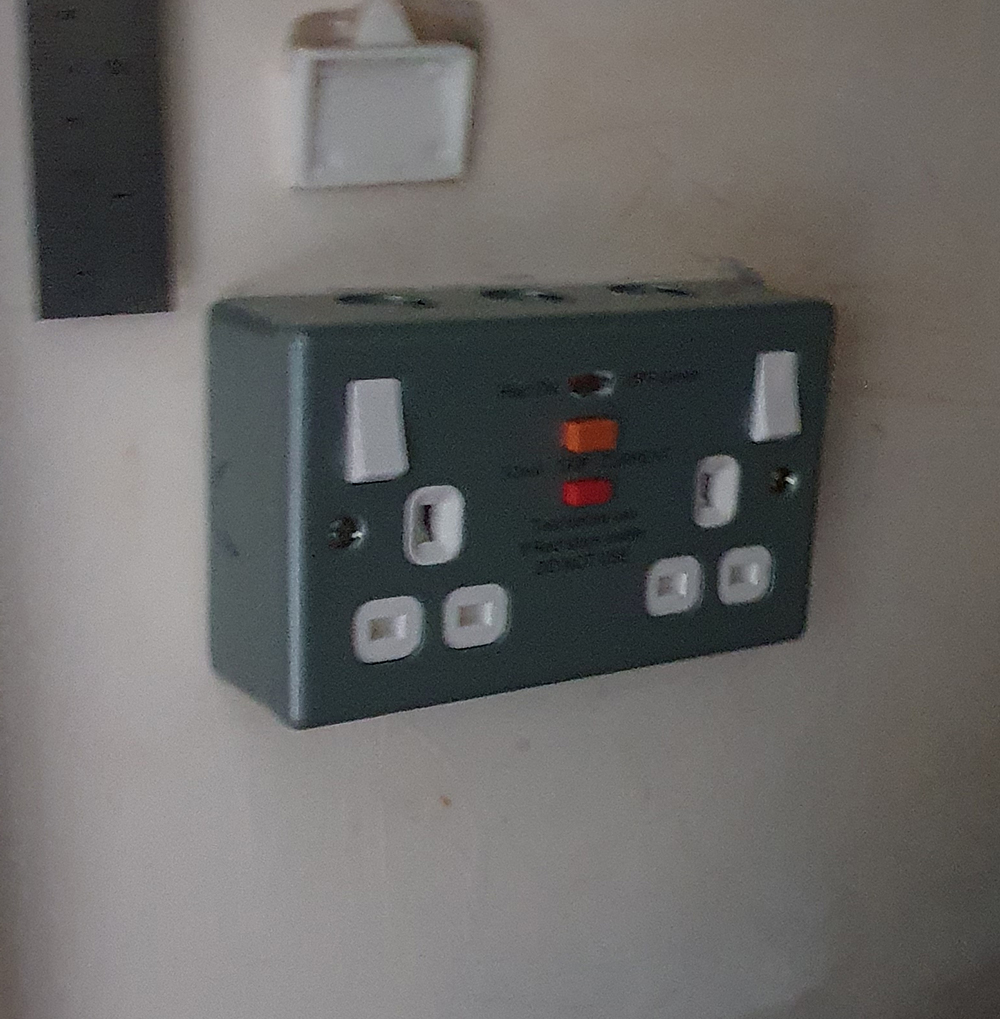

It is on a Radial circuit I believe (image attached of the fuse box). The immersion and the pump are both on a B16 (16A) connection via the fuse box. The water pump is on a 3A fuse. (Second attached image) is the RCD 2 gang socket powering both the Immersion heater and the pump which I have installed recenlty as a stop gap.

On that basis a cooker switch will suit your situation well, at least electrically. Mechanically you wiil need to ensure the heater flex is correctly restrained as already noted.
If the existing backbox is not deep enough and difficult to change there are spacer plates availablehttps://www.screwfix.com/p/schneider-electric-lisse-2-gang-spacer-white/2105j

3KW = 13A + 3A for the pump fuse = 16A total.

If you want to stay with metal the one SF do https://www.screwfix.com/p/knightsb...ched-socket-with-led-with-white-inserts/616vf and https://www.screwfix.com/p/vimark-nylon-male-comp-gland-20mm-2-pack/651vt
