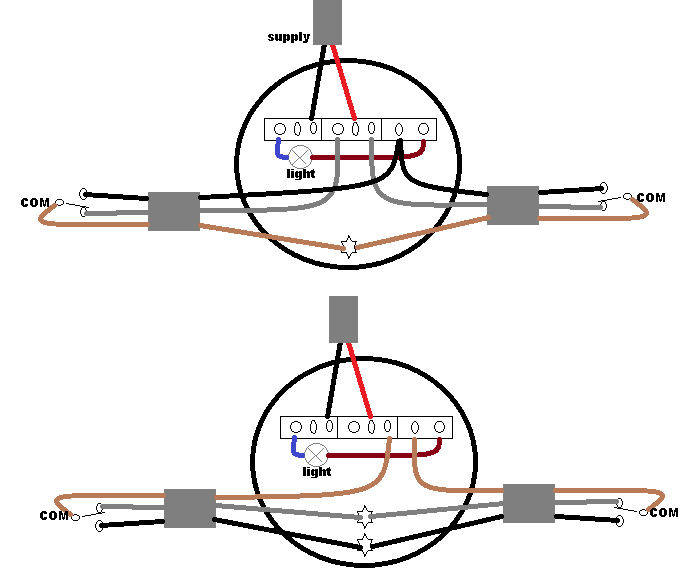

Hello All,
Can someone point me in the right direction of 2 way switching with the 3C+E cables coming into the ceiling rose..
Im fine with 2 way switching at the switches, but a little pointer with the cables coming from the rose will be a big help...
There is 1x T+E and
2x 3C+E
Hanging down......Thanks in advance

3 core cables are new, brown is the common at the switches. Black and red T&E
Ok.
Ceiling rose you say.
You will need an additional 5 amp connector block.
Make sure the power is completely off.
Put the two greys (sleeved brown) into the switched live terminal of the rose (where the brown pendant flex is).
Put the brown of the T+E and the the two blacks (sleeved brown) in the centre loop terminal of the rose.
Put the blue of the T+E in the neutral terminal of the rose (where the blue pendant flex is).
Put all three earths (sleeved green and yellow) in the earth terminal of the rose.
Put the two browns of the 3 core+E together in a 5 amp connector block.
There are 2 ways[excuse the pun] of wiring this.
I've made assumptions on wire colours but supply can be blue and brown if installed this century
Assuming the 2 way arrangement is new I've shown harmonised however the Brown, Black & Grey may be in any combination and not as shown here.
The first method requires one additional joint within the rose and the second method requires an additional two joints. Either method works well, the choice between the two is up to you.
The additional joints may be any method, choc bloc [5A connector strip] is popular, I'd possibly go for crimped connectors to save space which is always at a premium in roses.
I haven't shown earth wires to reduce complexity of the sketch but all 3 cables earth wire is sleeved green/yellow and connected to the rose earth tag, all incorrect colours should be sleeved brown [or red]

I happen to have selected different colours to Sparkright, any combination is correct in the situation.
