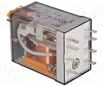

Normally I use a miniature power relay. Something like this...
....and solder short wires onto the pins which I sleeve, the wires then terminate at screw connectors instead of using a bulky plug in base. The whole lot will then fit in a standard electrical backbox with a blanking plate cover.

There is no reason the relay base can't be mounted on the side of the box and some octal relays and base will fit in some 100x100x50 boxes. and sometimes a 47mm double backbox.
There is normally another means other than DIN rail to mount them if it works out better for you
Far more sensible and reliable than a valve actuator and cheaper too.
