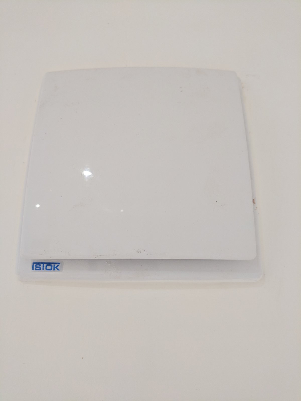

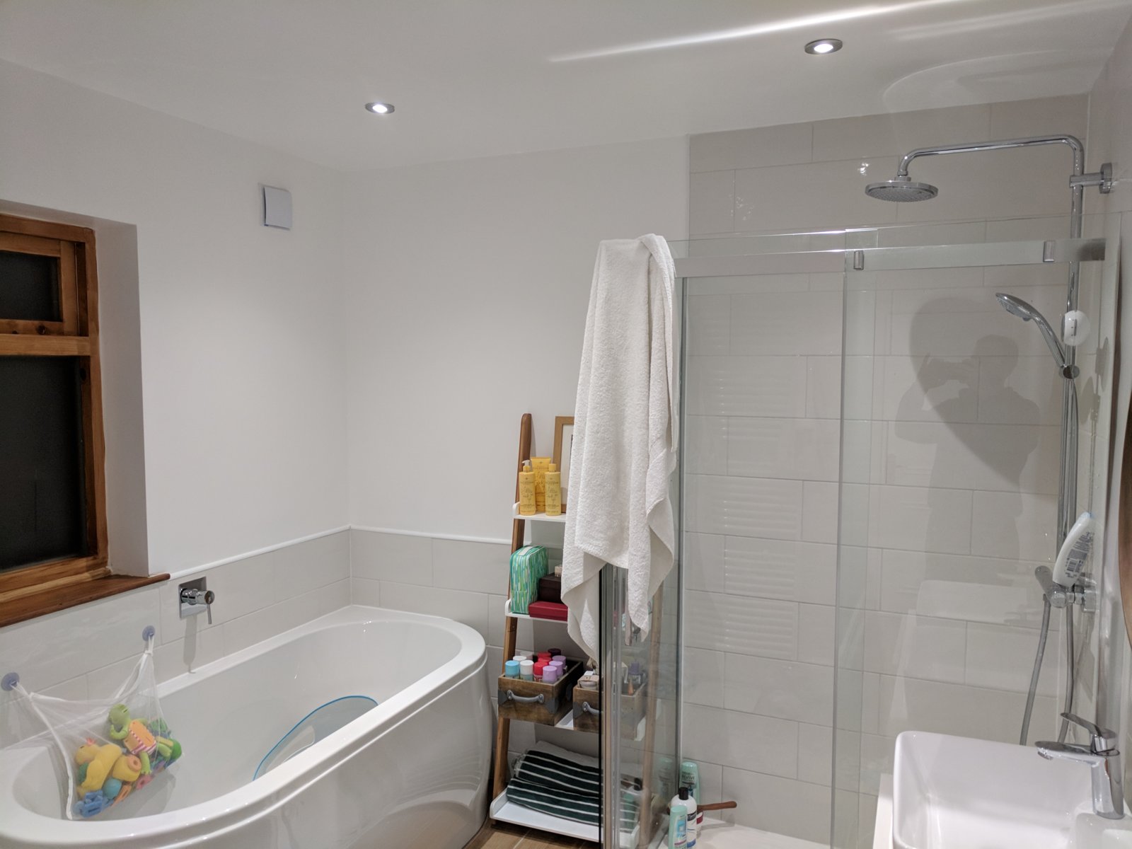

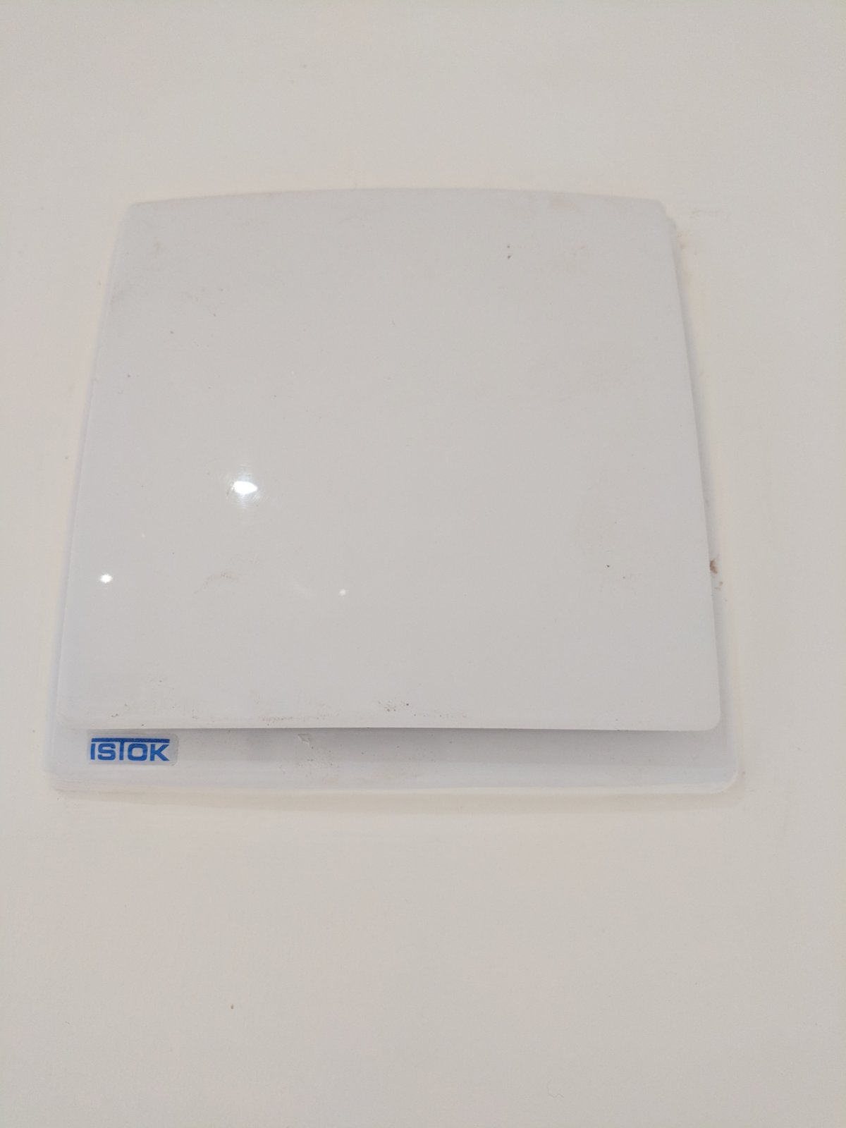

Hi the existing wall mounted extractor fan doesn't really clear the room when we shower so thinking of fitting one directly above the shower.
Can we spur off the existing fan wiring?
Will the switch fuse handle both?
Two might be excessive and we get rid of the original, but would be interesting to see how 2 compare to 1 and how just the new one directly over shower compares.
Electrically you can. The average fan is about 20watts so less than a light bulb.
But, seriously, if the fan isn't clearing the room, you should look at why that is: Check
  • You have a duct of perhaps 4" diameter. Can the same amount of air enter the room? otherwise the fan is trying to create a vacuum
  • Is the fan powerful enough? Many fans are cheaply made and just do not have the grunt to pull air much more than through a wall. use a centrifugal fan rather than an axial one.
  • Is ther a long duct, is it smooth, or corrogated.
  • Is the fan or the duct clogged up with fluff, gunk or other detritous
  • Are there backdraft flaps that are jammed shut
  • Is the fan a timer one that runs on after the light goes off. Calculate the room size and the fan throughput, maybe it needs to run on for quite a long time to change the room air. Use this calculator https://www.tlc-direct.co.uk/Technical/Ventilation/Ventilation4.html
And others that i cannot think of at the moment
If you have a second fan then be aware that the two will fight each other, if they are not balanced then the more powerful one will suck air into the room back through the weaker one.
Don't wait for the forum wafflers to start, TTC has given you all the correct info you require
Thanks Taylor,
You hit open the 1st and most obvious, air can't get in. The extractor is next to a window and opposite the door. Would you leave the door open a jar to create air flow?
I'm not sure how powerful it is, it has "Istok" on it but can't find it online.
It's only 6 months old vented directly out through the wall with the flexible piping.
The flaps are working OK.
The fan is on a separate switch so we leave it on.

The door ajar has helped, so will keep an eye on how it goes. I was concerned that condensation around the edges of the panes, on the wood windows may eventually affect the frame.
