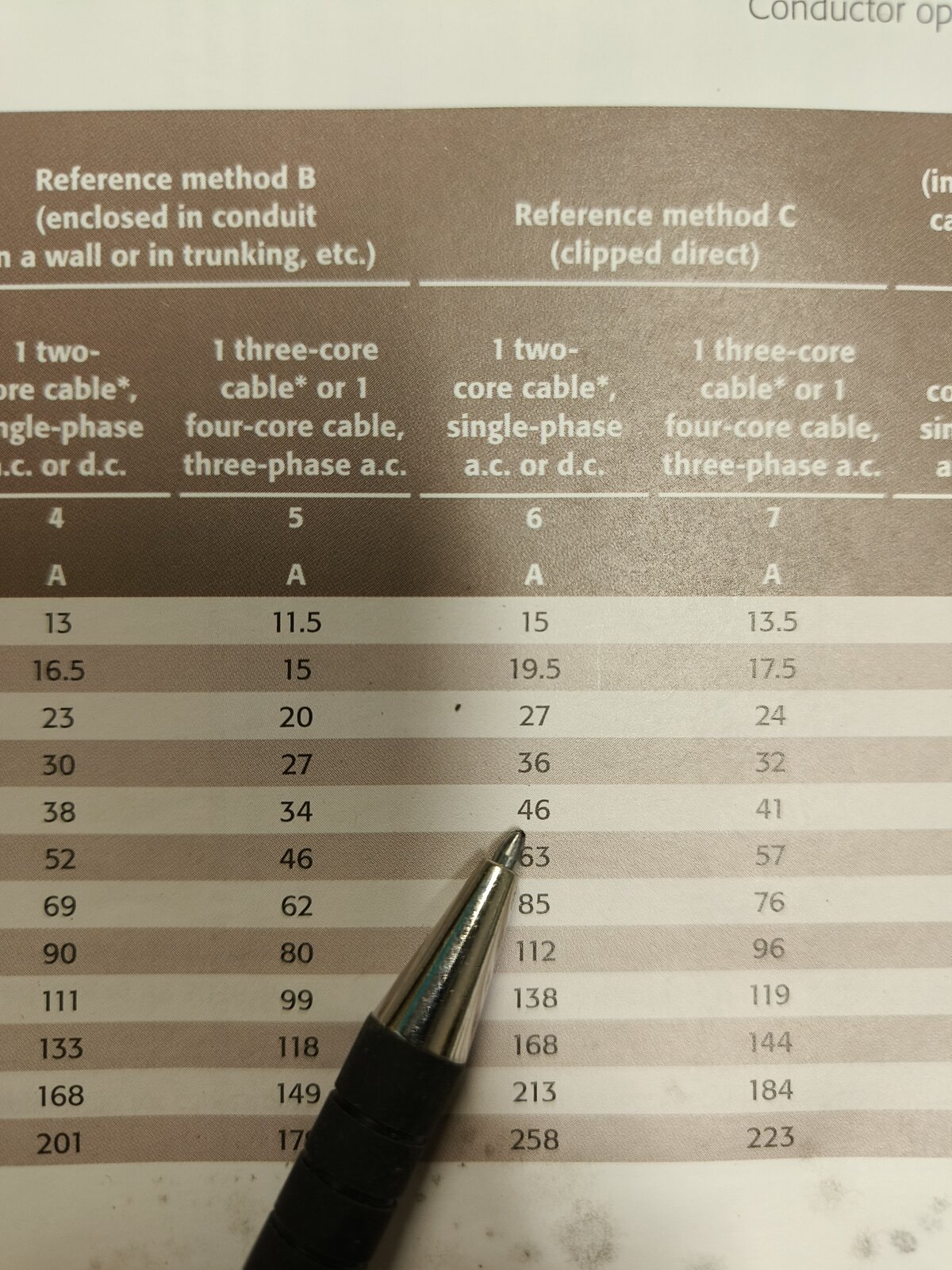

Thanks for the help peeps, yes I'm quite comfortable with the math, Just been reading up in my latest copy of the requirements these books cost me half a crown they're that old
Diversity = first 10A + 30% of remaining+ 5A for the 13amp outlet.
Therefore 7530/230= 32.7A
32.7-15=17.5
30% of 17.5=5.25
5.25+15= 20.25amps with diversity applied. 6mm T&E allows upto 46A and it could even be wired with 4mm. It's more a question on the 16A protective device required for the hard wired Microwave. It's not delivered yet, maybe the cord is light weight. With no spare ways in my CU, should I install a small local CU in the cupboard, though to be honest I'm inclined to treat all three as a combined load‍♂️
