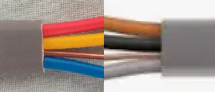

Genuine questions: Is there a reason for this lay-out?
In a single phase system, would it not be 'better' electrically if the neutral were where the black is instead of at the edge?
If you're thinking of the one possible 'advantage' of having a bare CPC that I mentioned, I suppose it doesn't make all that much difference. From that POV, the important thing is that, with either of those arrangements (i.e. 'as is', or with black and CPC swapped) the CPC is between the N and L(s).
I suppose one could just about argue that it would be 'better' if the P/L (as opposed to the S/L, if that's what the black was being used as) were adjacent to the CPC, but I think the relevance of the difference is probably pretty marginal.

Genuine questions:
Yes of course there is, the live conductors are are arranged in ph1, ph2,ph3 order.
Why? Are you meaning should we have used the yellow for neutral in previous colour scheme?
Perhaps you could share your enlightening moment.
I did, have you not read what you are referring to?
I assume the remainder of this is now clear after noticing the colour order I suggested.
Did they not do that? Edit - just realised you mean instead of Brown, Black, Grey.
I do not understand.
On the one hand, they did not do that. How could they?
On the other hand, they did not do the alternative either; hence the requirement (in sp) for brown or blue sleeving on black and grey wires.
Why? Are you meaning should we have used the yellow for neutral in previous colour scheme?[
As I recently wrote, I assume (maybe wrongly) that EFLI was talking about what I had said about the one arguable electrical advantage of having a bare CPC (and one positioned between L & N) - namely that it increased the probability that something penetrating or damaging the L or N conductor would also come in contact with the CPC, hence causing a protective device to operate.
I would guess that EFLI felt that such would be more strongly the case if the CPC were adjacent to the P/L (and N) rather than the S/L (and N) (when that's what the conductors were being used as) - but, as I said, I'm not convinced that there is a lot of difference.
Kind Regards, John

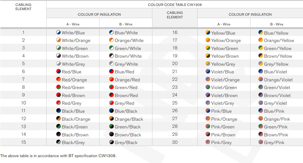

BT cable was single core and then body colour plus a band colour. Although some used BT cable for burglar alarms too.

I interpreted this:
a different way.
People who use black as the neutral on a harmonised 3 core+E should be lined up against a wall and shot.
Bang. Bang.
I see what the reasoning is:
It is that 3p used to be R,Y,B for L1,L2,L3 respectively and when the cable was used for 1p the Blue was quite naturally used for Neutral. Then harmonised flex came along with a Blue neutral so all was well and obvious.
However, when harmonised 3core&E; Bn,Bk,Gy; arrived, and when used for 1p, you, and others, for some reason decided that '3p L3' must therefore be used for Neutral even though most properties would still have been cabled in Red and Black with Black as Neutral.
Of course, any instruction to this effect; that Grey should/shall be used for Neutral; is irrelevant and impossible because Grey is not a colour that signifies Neutral so must be over-sleeved or marked for identification; exactly the same as a Black wire - the base colour being immaterial.
