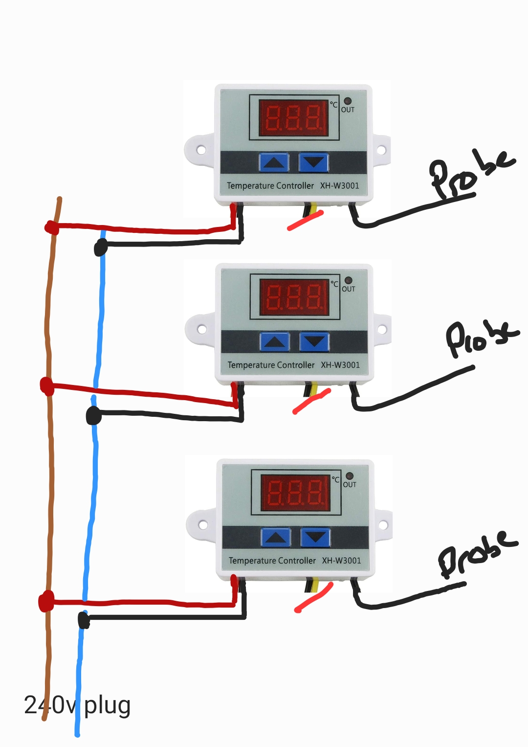

Hi all. Probably quite a simple question.
I have 3 temperature controllers with thermometers. I don't want to use the controllers, just the thermometer).
They are all 240v
I have mounted them to a board and want to have one 240v cable on a socket to run them in parallel.
Question 1: what is the best way to use the cable without cutting it to connect these up to?
Question 2: can you solder 240v devices onto a cable as opposed to using a connector of sorts.

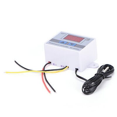

...just a quick look for xh-w3001 shows 12V versions or 220V AC - the 220V AC versions look particularly dodgy for use on our mains supply.
It is supplied with a red and black cable for connection to the supply, rather than a double insulated mains lead.

1) Depends, how long is a piece of string?
Why do you not want to cut it? Get a long cable and wire from the first, round to the 2nd and so on like a daisy chain, connecting the live from the first along with the live out to the 2nd in the same terminal, then when you get to the third connect the live from the 2nd and the live from the length that goes to the plug into the 3rds live terminal.
Do this for the Neutral and Earth into their respective terminals too.
As long as no copper is dangling out of the terminal and both are firmly secured in it then they should be fine.
2) Why do you want to solder them? do they not have screw terminals?

I did think it was odd that they have a red and black, also the instructions said red to live black to neutral, which is so odd.

Working in the controls industry we tried these devices, they had all sorts of hope and appeared to fufill many promises...
they disappeared rapidly from our list of worthwhile products, one of the problems was loss of thermistor resulted in the device staying in one state and the construction quality was horrendous, a fairly minor knock of the thermistor was often enough to make it fail.
Oh and the wires were frequently wrong colours or simply soldered to the wrong place on the board.

Rather than having chunky terminal blocks I thought if I strip 2 single core cables along the cable I can simply solder the red and black as required, no cuts.
The device has no screw connectors.

Because of the lack of double insulated cable connections, if I was to use these (especially as they are to be mounted together); I would fit them all into an enclosure (with cutouts for the display) - there would then be no problems with lack of DI, and you can make your connections inside with a standard terminal block.
One mains cable could enter through a cable gland.

Having said that, and having a look at Clive's video; if the OP is confident with soldering, they could solder on some 2 core 0.5mm2 mains flex (directly to the PCB) and add some strain relief.
...... one of the problems was loss of thermistor resulted in the device staying in on state ......
And thats what would worry me.
If the designer hasn't taken the time to make sure that device fails safe (ie. failure = output OFF) then what other safety features has he omitted???
