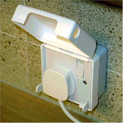

3 Pin Plug in the bathroom for a Waterpik

There are two different questions one is "is it safe" the other is "does it comply with regulations" I am sure you can make it safe not so sure about complying with regulations.
To buy a standard shaver isolation transformer is cheap. But to buy a 50VA isolation transformer is around the around the £50 mark and by time you are boxing and fusing then more around the £75 mark.
The idea of the shaver outlet is there is only a single item connected and there is no earth it also has a switch so there is no power to pins until a plug is inserted to build a DIY version would not be easy.
So I would assume only real way is the plug requiring a tool or key for access. Something like this
may be considered as complying although much would depend on if splashes could enter the unit. This one is also a contender in both cases the cover is lockable. The common Clipsal version
is not lockable so would not comply even though it does nearly the same thing.
Personally I think with RCD protection and a cover the risk is very low assuming using methods to seal against ingress of water if not already RCD protected using a RCD FCU

I simply dont see the problem with plugging it in outside the bathroom. Its exactly how most bathroom fittings are connected. The "dangerous" connections are behind a wall or in the roofspace, and the appliance itself (be it an electric shower, extractor fan, light etc) is IP rated suitable for use in the environment.
If the flex isnt long enough, use a small waterproof JB to extend the flex and take it either up thru the roof into the attic, or thru the wall into one of the bedrooms, and connect in there.
