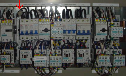

I've seen something similar in control panels with a 200mm high plastic busbar system with facilities to mount moulded plastic din rails on the front. I haven't encountered the system for 13 years and wondered if it had gone out of fashion.
It worked very well but 1, 2 or 3 tri rated tails were welded into a plastic 'plug' which snapped into the top and needed a lot of space to withdraw and replace, therefore only 3's tended to be used which sometimes meant spares were left over. As a control panel 'building block' they sometimes took up a lot of space and frequently looked untidy.
