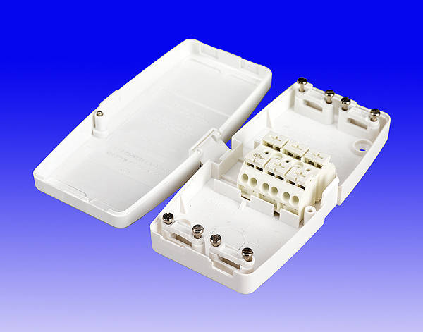

Since you can make that hole as big as you need, I would of used one of these 32 A Ashley MF junction boxes.
Box secures to the wall and good clamps on cable. Used these under floors.

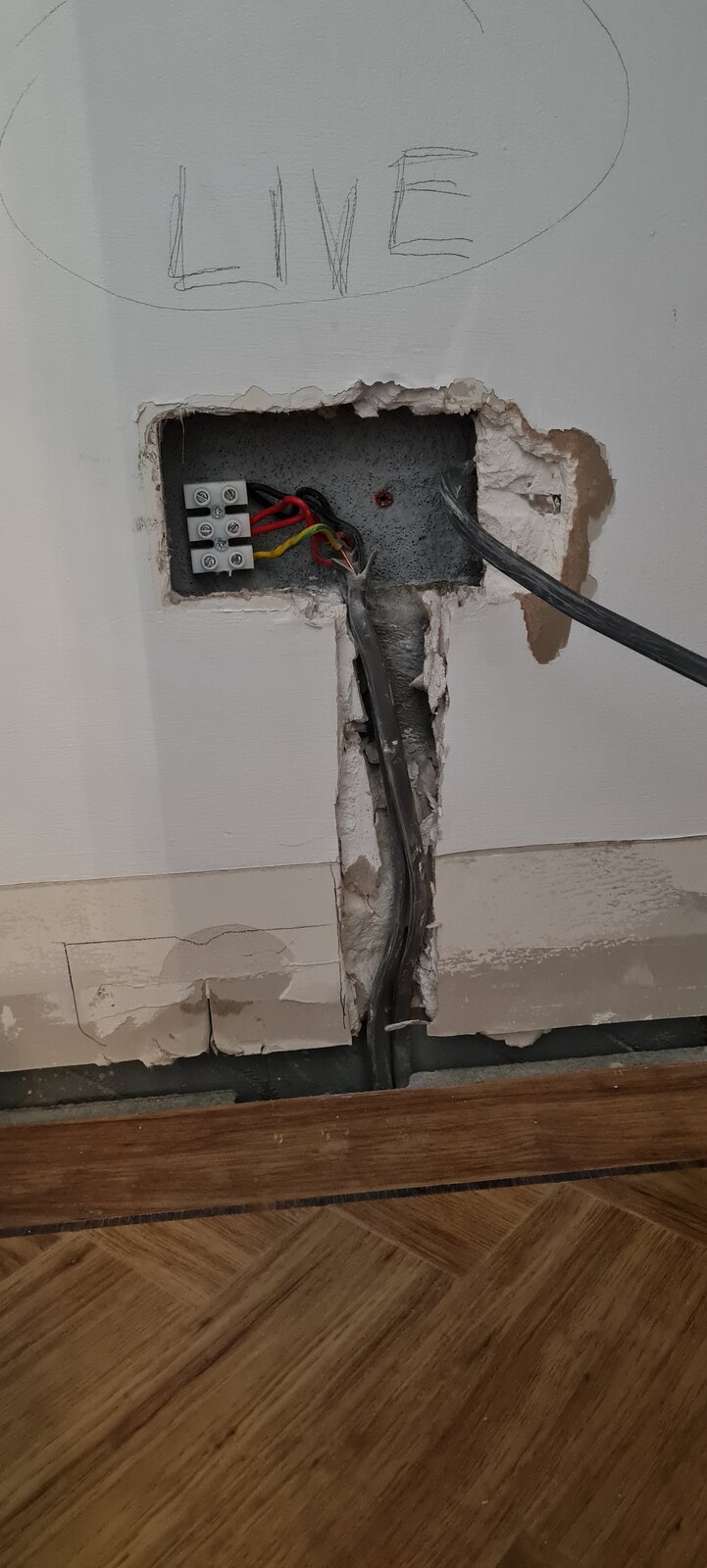

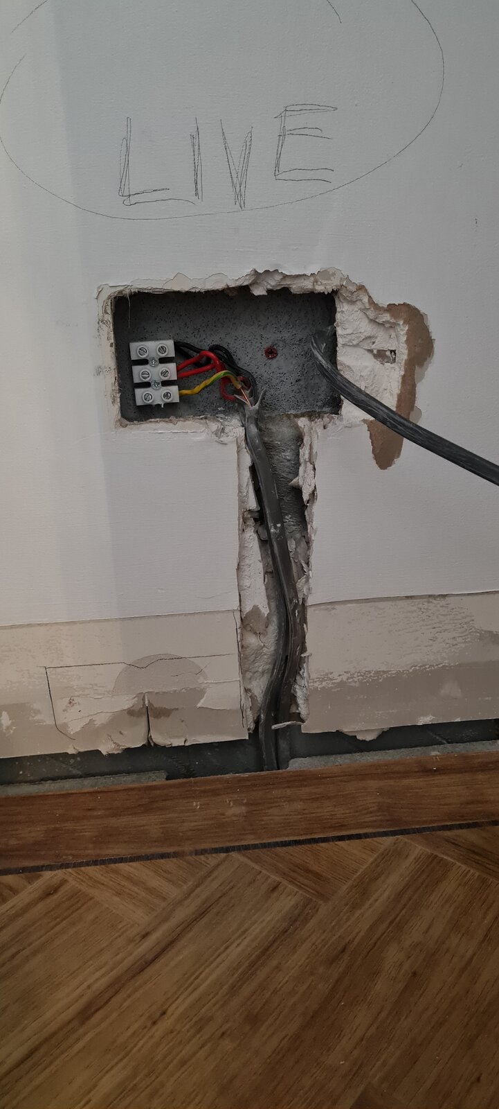

Got the skirting board off and seems a enough room for the box to go behind it
Just before I do anything else.
Thought I'd ask to see if the drywall box is in its best place? The Skirting board will be removable now to access if any problems. Would a junction box be better behind the skirting to connect the wires up?
What would be the best plan of action to deal with the wires feeding the original socket, just push them back down into the space where the floor is? fold them over on them selves or cut them shorter.

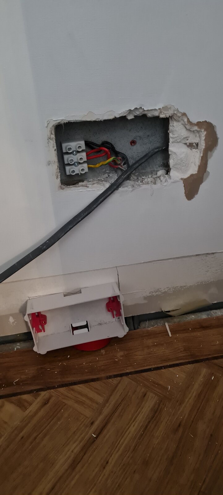

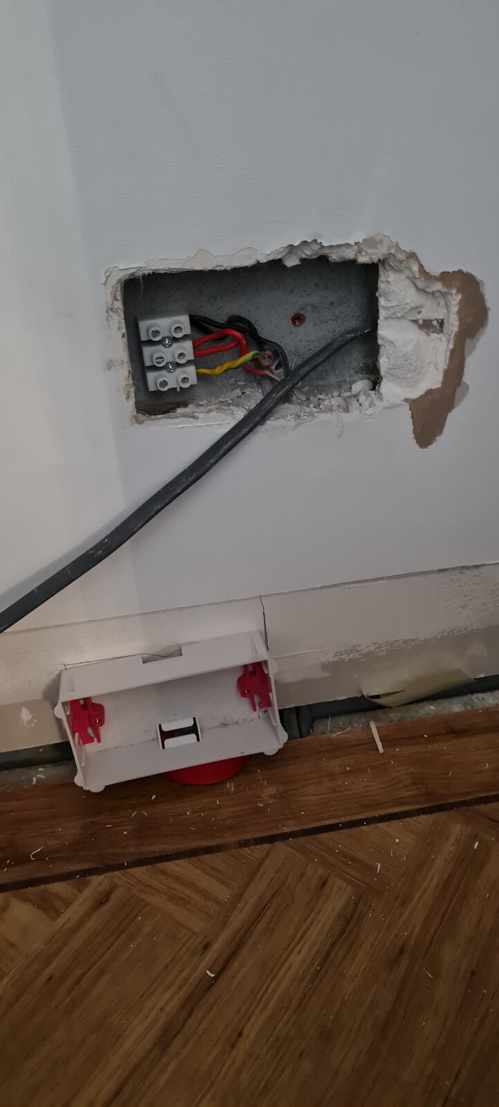

Actually now its i have access would the wago connection box
https://www.toolstation.com/wagobox-junction-box/p92231
and these wago connectors be fine for the job?
https://www.toolstation.com/wago-2273-3-way-compact-pushwire-connectors/p24872
Note that you can buy Wago connectors in packs of 10 from TLC
thanks I also had that webpage open and i ordered a few more bits for free delivery, sadly the wago box wouldnt fit in the space so i was hoping a conventional (circular) junction box would work
