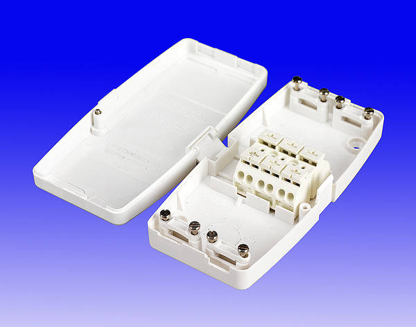

Not an ideal situation, having to bury a join, but it happens all the time, sometimes you can over stress it.
Since you can make that hole as big as you need, I would of used one of these 32 A Ashley MF junction boxes.
Box secures to the wall and good clamps on cable. Used these under floors.
