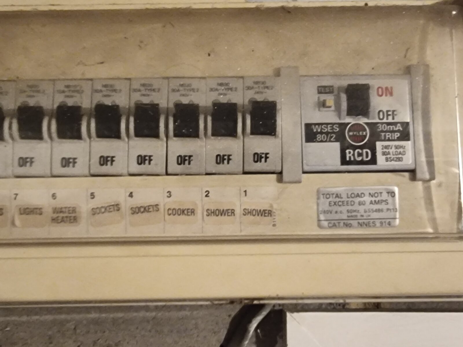

Its on the circuit breaker it says 30Amp, its an RCD i have. The cable is 4mm thick to the cooker.

It's an old Type 1 MCB, is it? Not likely an RCD.
Are you sure it is 4mm²? It's usually 6mm².

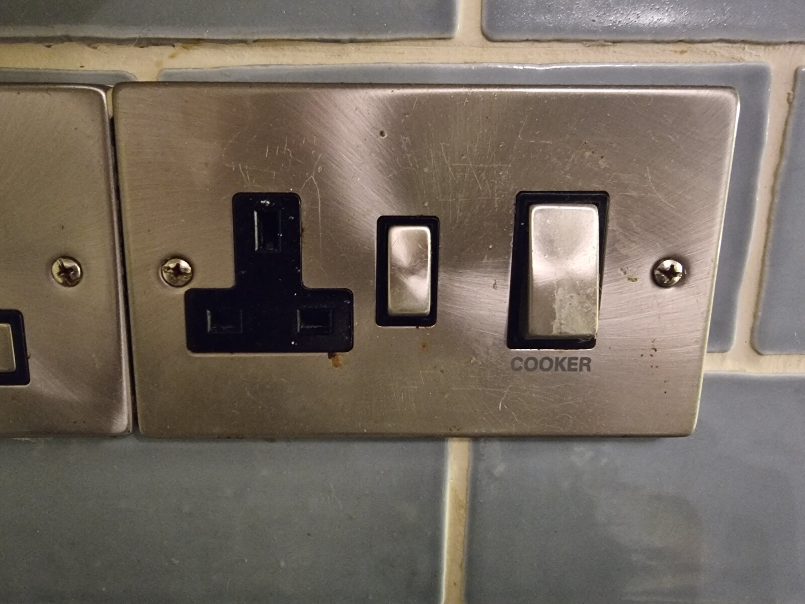

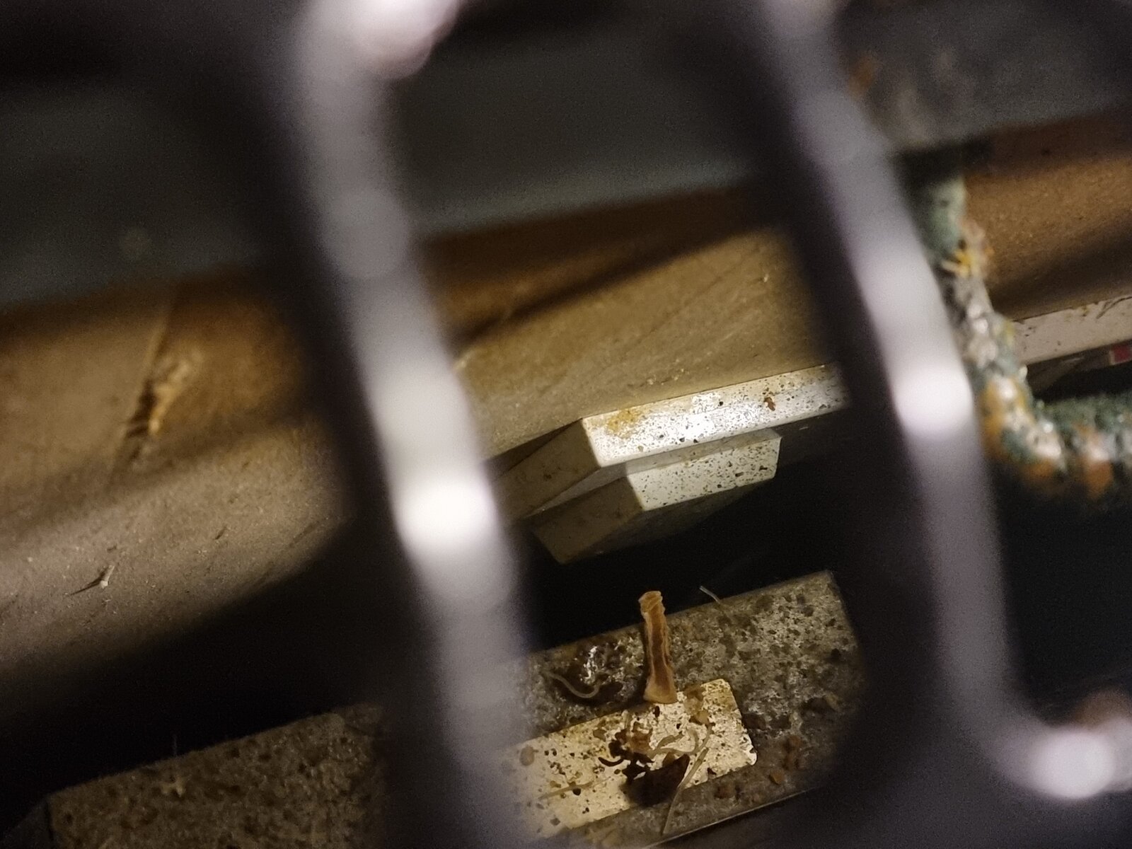

Ive attatched pics of the cooker switch, the connection behind the current gas cooker and the rcd.

It's an entirely standard 30A cooker circuit, as installed in millions of homes everywhere.
Very likely with 4mm² or 6mm² cable connected to it.
You don't need 10mm² cable, or to replace anything. Any freestanding cooking appliance intended for domestic use can be used on a 30A circuit, as can other combinations such as a separate hob and oven.
although it was measured with a tape measure roughly
That isn't how cable sizes are determined, if the 'electrician' thought that was an appropriate way to identify it, you need to find someone else.
The presence of 2x electric shower circuits is more of a concern, as is the obsolete 30+ year old RCD covering all of the circuits.
