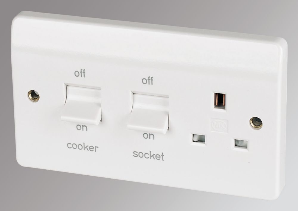

At the moment the cooker circuit runs from the CU up into the ceiling, where it connects to something like this:
ae235
A cable runs from this down to the kitchen and then connect to one of these
ae235
Which then goes to a cooker connection unit.
The reason that I can't easily use a single connection unit is that the oven and hob are on different sides of a doorway.
So I intend to add a new switch and connection unit for the hob, and add another 6mm cable from the junction box in the ceiling down to the new switch (I ideally wanted to change the junction box in the ceiling with something with a bit more internal space, just for ease)
Or should I put a new junction box in the kitchen, and just chase a route over the doorway?
If I change the box in the ceiling, or put a new box on the kitchen wall, what would be the best products to use?

If you already have that round junction box in the ceiling I would stick with that.
It should have plenty of space in it (if it looks like a "32A" one).
It may not be complaint, but it will last for decades
