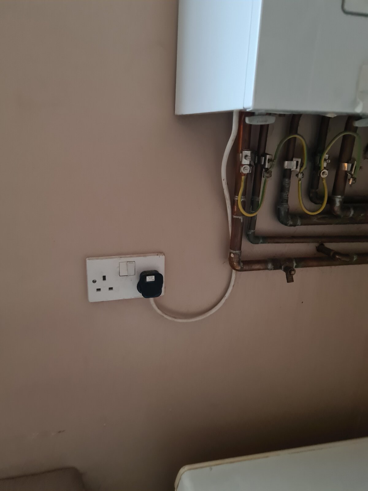

Hi guys ...i just had a boiler health check done by homserve to see if they will cover my vsillant combi boiler..they guy checked it out and said its working fine...however he said the plug needs to be connected to a 3A fused spur...by the socket ...see pic..he said the present plug has a 13A fuse in it and a spike could damage the workings of the boiler. I said why can't I just put a 3A fuse in the plug? What you guys think?

Boilers can be run off plugs but it should technically be an unswitched socket. You're right though, a 3A fuse in the plug would do the same job as one in an FCU.

The boiler is about 8 yrars old.. They guy just left earlier have to wait to see if homserve will cover my boiler...so basically I need to run a 2.5mm cable from the socket into a 3A fcu to which the boiler cable is wired too?
As above -
Keep the plug (you do not have to have a FCU), change to a 3A fuse (although not really needed), if you want to change socket to a switch free version.

Best practice to fit a FCU with a 3A fuse IMO.
You can get a dual single gang back box to replace you current back box and then change it to an FCU and single gang socket.
Could do as sfk mentioned but will homserve approve that...I was thinking of getting a surface mount back box..and fitting the fcu onto that...the surface mount box will have pushouts for cable coming in from socket and boilet cable...but how will I add 2.5mm cable to existing socket to go to surface mount box?..dont really want to cut out a channel...could I just cut out a notch in the existing socket and take the cable up and cover cable with clip on cover?....saying all that will wait to see what homserve say...but really a 3a in the plug should do it..
As mentioned you can get one of these, take your old back box out and replace with this. Then you can single socket and fcu it.

Over the years I have been asked to look at quite a few systems where the householder had been trying to replace a part (usually a room thermostat) and caused a live to neutral short circuit. Several times, the overload had caused the programmer switch contacts to weld together. Every time I have found this to have happened, the system always had a 13A fuse fitted. Not once have I found it happen on system with a 3A fuse fitted .....coincidence? .....maybe .....

If you change the back box, the double back box is wider, so will involve some effort chopping the wall to make it wider. It might be not much more difficult to simply add a second single box alongside, for a fused, double pole switched spur unit. That would also free up your socket.
