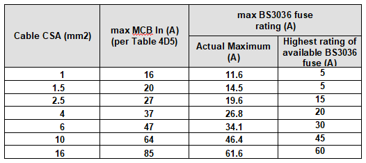

I don't have any figures for CCCs (max fuse/MCB ratings) for Imperial cables, and I'm not sure where your 'current ratings' for metric cables actually come from, but the actual situation as regards metric cables is (per BS7671) as per the Table below. As you can seen the effective CCC of 6mm² cable (highest permissible available fuse rating) when protected by a BS3036 fuse is, at 30A, lower than that of 4mm² cable protected by an MCB (37A - hence, in practice a 32A MCB).

Thanks for the info, which I'm comfortable with other than 1.5mm² & 4mm² which were regularly used with 10A & 25A respectively.
I'll repeat my recollections
the above metric current ratings are based on the max size of the fuse used and not actual ratings. ... In the mid 70's I did a fair bit of domestic new build work and circuits were pretty much installed as above regardless.
Meter tails back then seemed to be only 2 sizes metric sizes; 6mm² up to 30A or 16mm² including those rare installations with 100A fuses.
