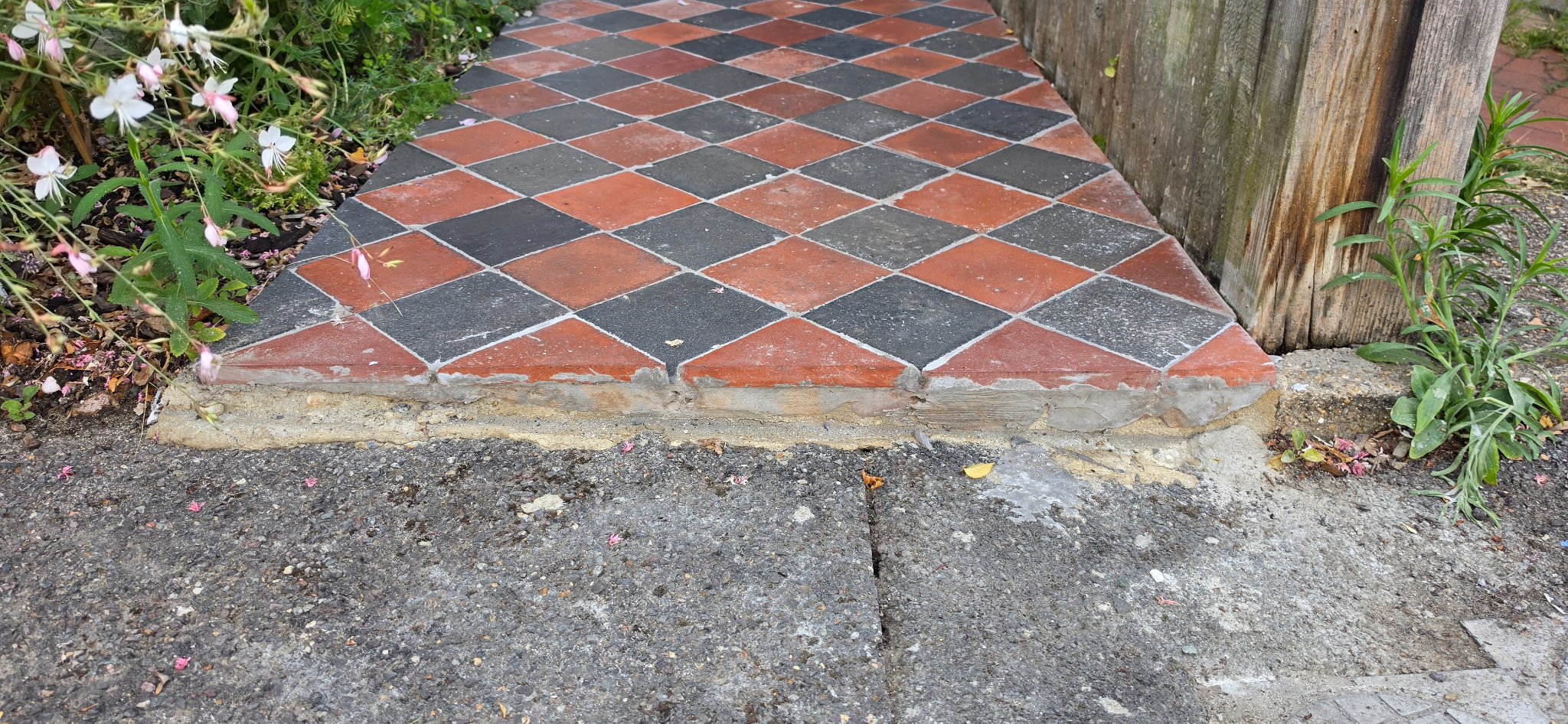

I think my original question was a bit confusing. What I'm trying to do is finish the edge of a path that's looking a bit rough.
The tiles are actually 22mm thick and my idea was to cut the end of the path tiles at 45 degrees, and to use leftover tile also cut at 45 degrees to cover the ugly concrete bit in the pic, hence my question about the grinder attachment.
Is this doable, a sensible idea?

If I understand what you want want to do, you would need to remove the existing end tiles and chamfer them.
Wouldn't it be easier to find a black tie of a suitable height and then trim it to height?
I would not want to be doing this with an angle grinder, this forum has already had a members death through the misuse of one.
Instead look to putting something that achieves what you want in front like the tiles suggested above, or if you want a chamfer make one with cement/morter and tiles etc.

you need to dig out the concrete underneath what ever happens so not as simple as cut at an angle and plant angled tiles on front
so my thoughts
remove around 40mm from under the tile front edge then cement in tiles underneath at around tile thickness back
but fully just my thoughts

I think so. I'll use black tile or corten steel as edging. I'll get some samples and see which looks best.
Stainless steel, or aluminium sounds like a good option. You could use as MS polymer such as OB1 to hold it in place.
There are numerous online companies which will cut it to size and polish/round the sharp edges.
I'm more inclined to go for the rusty look of corten steel. If you know of companies that will cut to size then do share. I'll search also.
