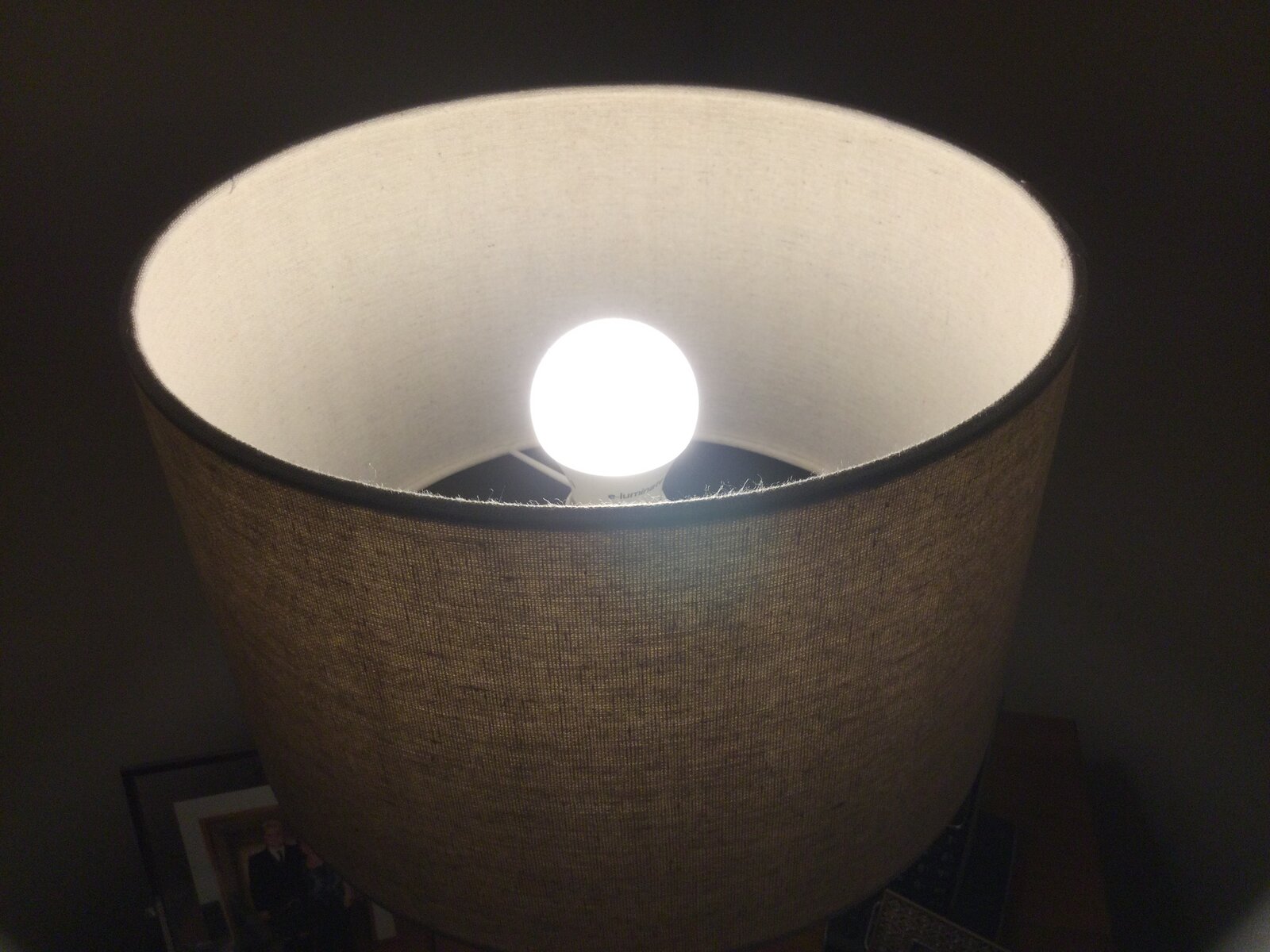

Have just bought a new table lamp and the instructions on the box state that the maximum LED bulb wattage is 7w. I believe that this is the equivalent of the old 40w bulb and it’s just not bright enough. Is there any reason why should not exceed the suggested wattage?j

The 40 Watt maximum is set by how much heat the lamp can tolerate. With an incandescent 40 Watt lamp there will be about 30 to 38 Watts of heat generated.
Hence a 30 Watt LED lamp could be fitted before the heat was excessive for the lamp.
But the maximum is stated at 7 watts. Clearly 30w is more than 7.

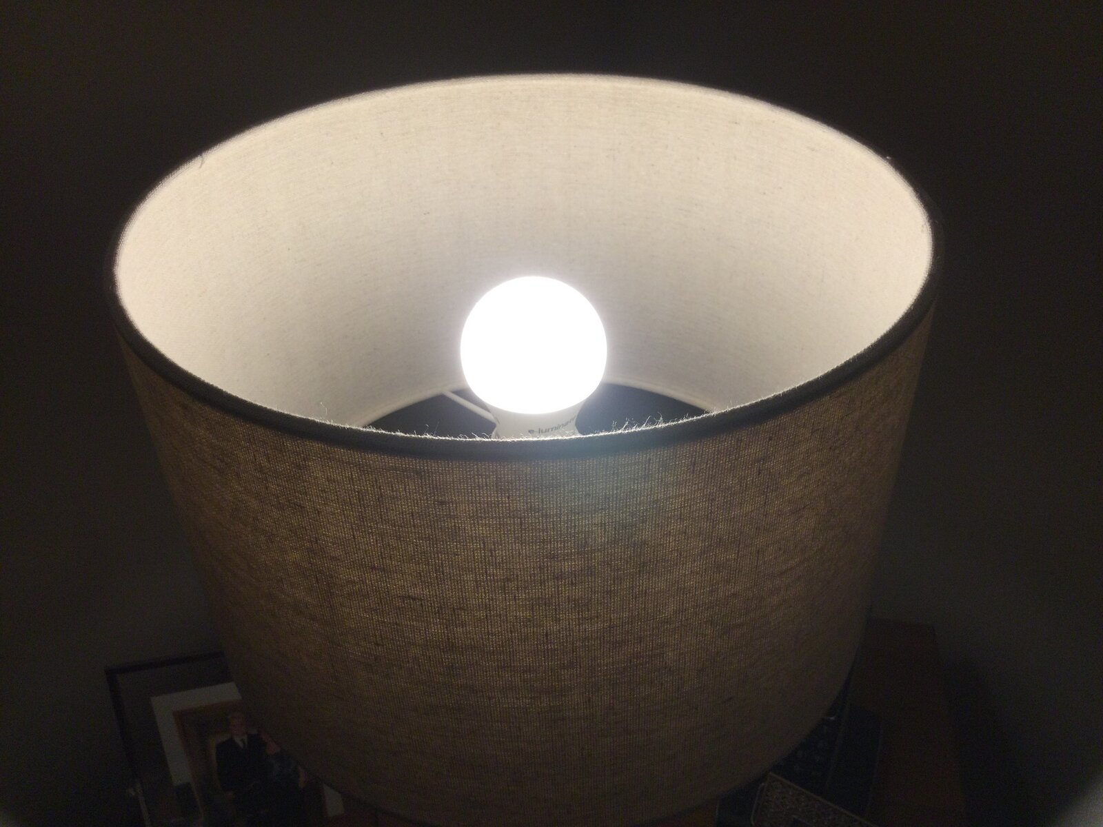

The first pic below shows the actual lamp and although I can see the second image which is shown alongside the actual ad, I haven’t a clue what it means.
93FD7789-384C-4B1F-8102-AE96A0CAFE3E.jpeg 8454873C-3241-4807-A204-51BA7293BF3A.jpeg
I can't think of any reason why a lamp should have a different rating due to type of bulb other than in-rush with some fluorescent versions. It does seem some one has looked at the equivalent chart when not really applicable.
However I find with very local lamps bulbs sizes rarely need to be over 5 watt, so table and standard lamps tend to be 5 watt, ceiling lamps need to be higher output, my living room 8 x 6 watt in ceiling lamp.
The rules say consideration should be given to manufacturers instructions, not blind following of their instructions, and when you get a battery operated device with instructions on how to fit a plug it shows how manufacturers are not that careful when writing the instructions.
So if the instructions said 700 lumen and 40 watt maximum then it would make sense, some thing in the lamp can't take over a set amount of light and set amount of heat or current. But 7 watt = between 550 and 700 lumen so if there is a problem with light output it would be written as a lumen limit not watts.
As JohnW2 says, this is very likely a blind 'conversion' from a 40W incandescent bulb without any additional thought.
There are occasions where a lower rated LED bulb would be specified, such as in an enclosed downlighter with little ventilation.
In your case, you have a well ventilated lamp with heat able to escape upwards and out of the way.
Fitting a higher wattage LED seems very doable, but at your own risk and at the cost of voiding the warranty ;)
Some IKEA lights don't work when the maximum load is exceeded. One of the pendants I bought just had a PTC in the lamp base to stop you putting in a higher power lamp.
I did phone the supplier and the agent suggested that I should try a higher wattage bulb. However, when I asked if this might not be too hot for the shade, (what do I know), the reply was, (Oh, you may be right, better not then!). She also offered a refund if I cared to send it back.
