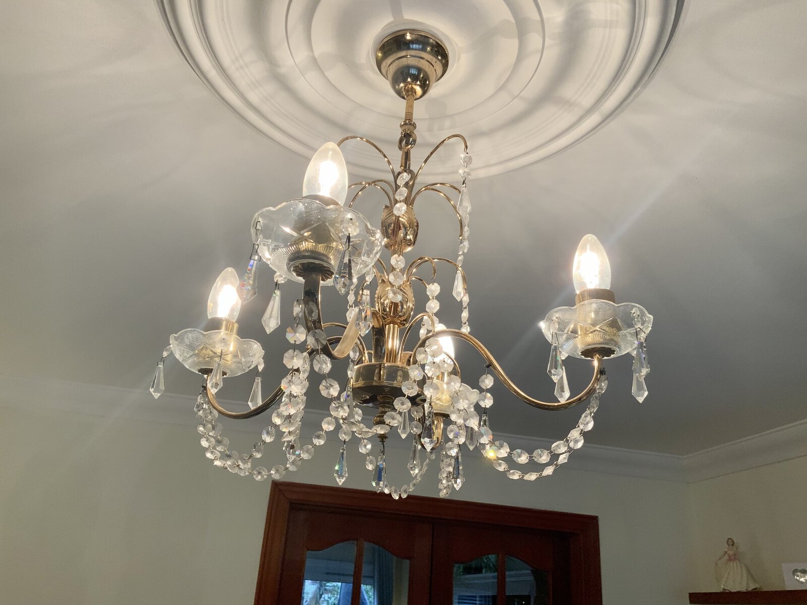

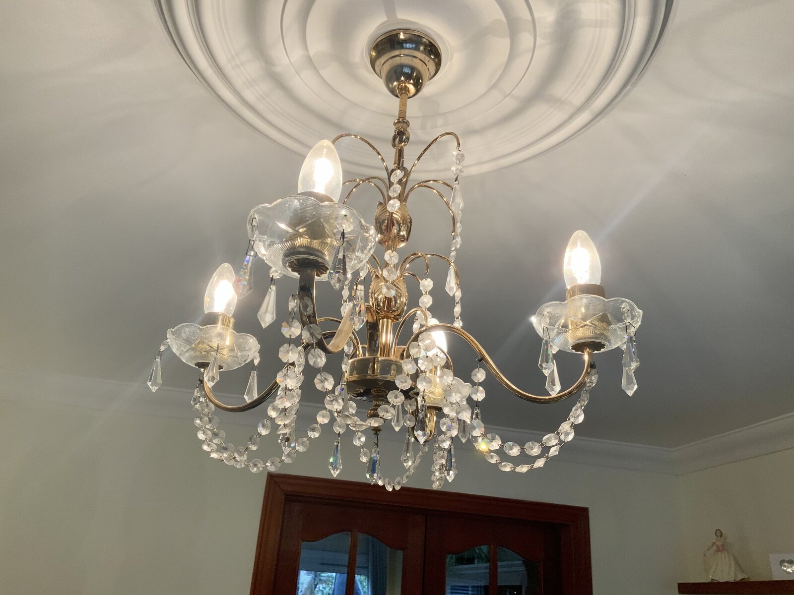

I have changed the 8 GU10 spot bulbs in the kitchen for LED's and none of them have blown in the past year (they would pop the breaker when they blew) but we still have a total of 20 candle bulbs throughout the house and if they pop when the lights are switched on, the breaker will pop too. The ones I have been getting are ones that look like they have a halogen bulb in but coincidentally I bought a pack of 20 only this week and they are the old style filament type. I don’t think I’ve seen them for ages.
Sooner or later I think you'll convert to an LED system. No transformers; run cool; long-lasting; cheap to run.
this is for your candelabra? No, they all seem to have the thick white base.
apart from the more expensive "imitation filament" ones
https://www.wickes.co.uk/search?text=candle
Yep, our 35 year old chandeliers and wall lamps. Well, we are in Essex! :LOL:
