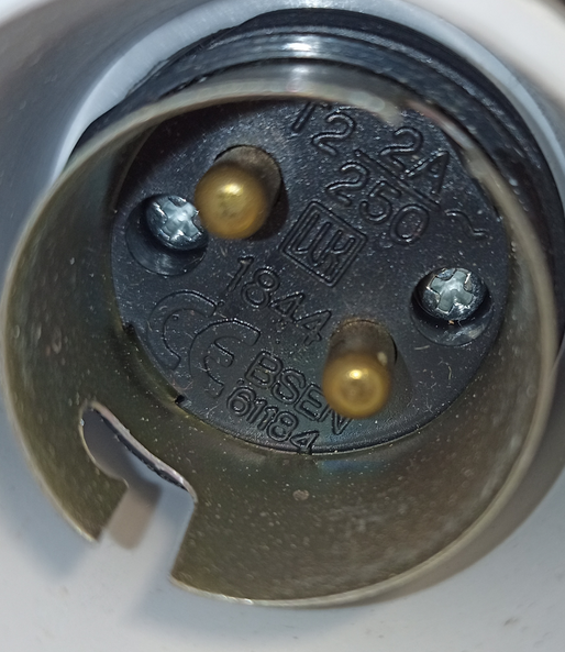

5 amp fuse on lighting circuit?

BS EN 61184 says:
5 Standard ratings
5.1 Standard rated voltage
For all lampholders only a rated voltage of 250 V is allowed.
Lampholders B15d are not intended for use in circuits with ignitors.
Lampholders B22d shall not be used in circuits with ignitors without approval from the
lampholder manufacturer.
NOTE From the theoretical point of view, the minimum creepage distance required for a holder B22d will result in
a clearance sufficient to withstand a pulse voltage of 2,5 kV.
The measures required to allow easy contact travel and lamp removal might in some
situations, however, be accompanied by unforeseen reduction of the clearance without
influence on normal operation (without ignition) where only the creepage distances are
critical.
BY22d lampholders are specially designed for use in ignitor circuits.
5.2 Standard rated currents
Standard rated currents are:
– 2 A for lampholders B15;
– 2 A for lampholders B22.
The rated current shall be not less than the standard value. Rated currents higher than 2 A
are allowed.
Compliance with the requirements of 5.1 and 5.2 is checked by inspection of the marking.

This is just one of three different brands I have and they are all rated thus:.....
BS EN 61184 says: ....
...Standard rated currents are:
The rated current shall be not less than the standard value. Rated currents higher than 2 A are allowed.
Interesting. As I implied before, even if those are the 'ratings' (which presumably implies that they have to pass tested at 2A), I do doubt that there are many that could not safely handle a fair bit more than that - the 'components (like pins and terminals) 'obviously' could, the only uncertainty relating to the electrical connection between the holder and whatever was plugged in.
As I also said, when used for the intended purpose ( :) ), anything above 2A would be moot - which perhaps is the thinking behind the minimum requirement of there Standard?
Kind Regards, John

Well, it's been demonstrated that I was wrong 'to find it hard to believe' that it was true, but the reason I said that was explained in the rest of my sentence, which you have omitted from your quote. The sentence in full was ...
JohnW2 said:
Even if that were true (and I find it hard to believe it is), I would have to wonder what 'rated at' would actually meant in that context, since it's very hard to think of how, even if one wanted to, one could design a lampholder which could not safely 'tolerate' a lot more than 2A!
Kind Regards, John

I'd imagine the current limiting factor will be the spring or spring tension.
... I'd imagine the current limiting factor will be the spring or spring tension.
werll, the contact between the 'pins' of the holder and the bulb/whatever that was plugged in -0 since, as I have said, the components themselves (pins & terminals) are clearly capable of carrying a lot more than 2A.
However, I would have though that those coil springs maintaining the electrical contact would be at least as good as the springy bits of metal 'gripping' the pins in any other sort of socket (BS1363 etc.), so I'm not convinced that is, in itself, a very good 'explanation'.
Kind Regards, John
The actual contact area of a BC pin to the lamp is small. It is just the very tip of the pin. They
The contact area of a plug and socket is much higher.
Yes, that is true (although the effective "contact area of a plug and socket" can be a lot less than one might think. I remain somewhat surprised, but its seems to be 'how it is'. Even the "contact area" between conductor and terminal of a plug or socket can also be 'small'.
