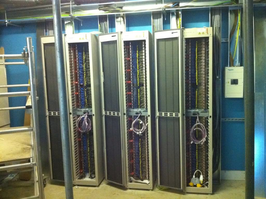

Here's the dimmers.
There are three racks at the moment with an isolator in readiness for a fourth as / when funds allow. The circuits for the fourth rack have been doubled up with the third. They used up nearly an entire DMX universe just on the dimmers :lol:
The panelboard also fed the non-dim circuits from a standard TP&N dist board, and something else too which I can't remember, but they were not connected it the photo.

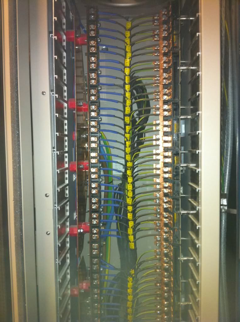

Here's some of the wiring inside.

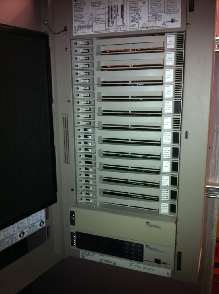

The dimmers then get loaded with modules like these.
This was a small rack on a different venue we did. It controlled the house lights and the stage workers. You can get dimmer or switching modules for dimmed or non-dimmed circuits. Each module controls 2 channels and can be swapped out in seconds if one goes faulty.

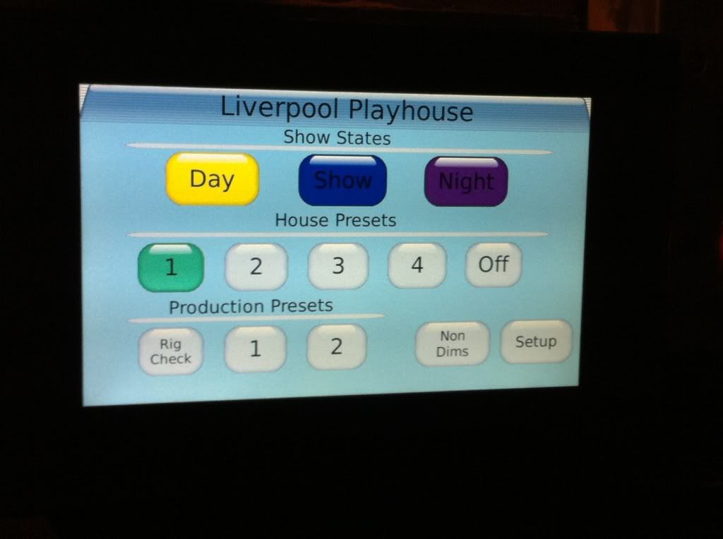

This dimmer was linked to the main stage dimmers as part of a paradigm system all controlled by touch screen :D
