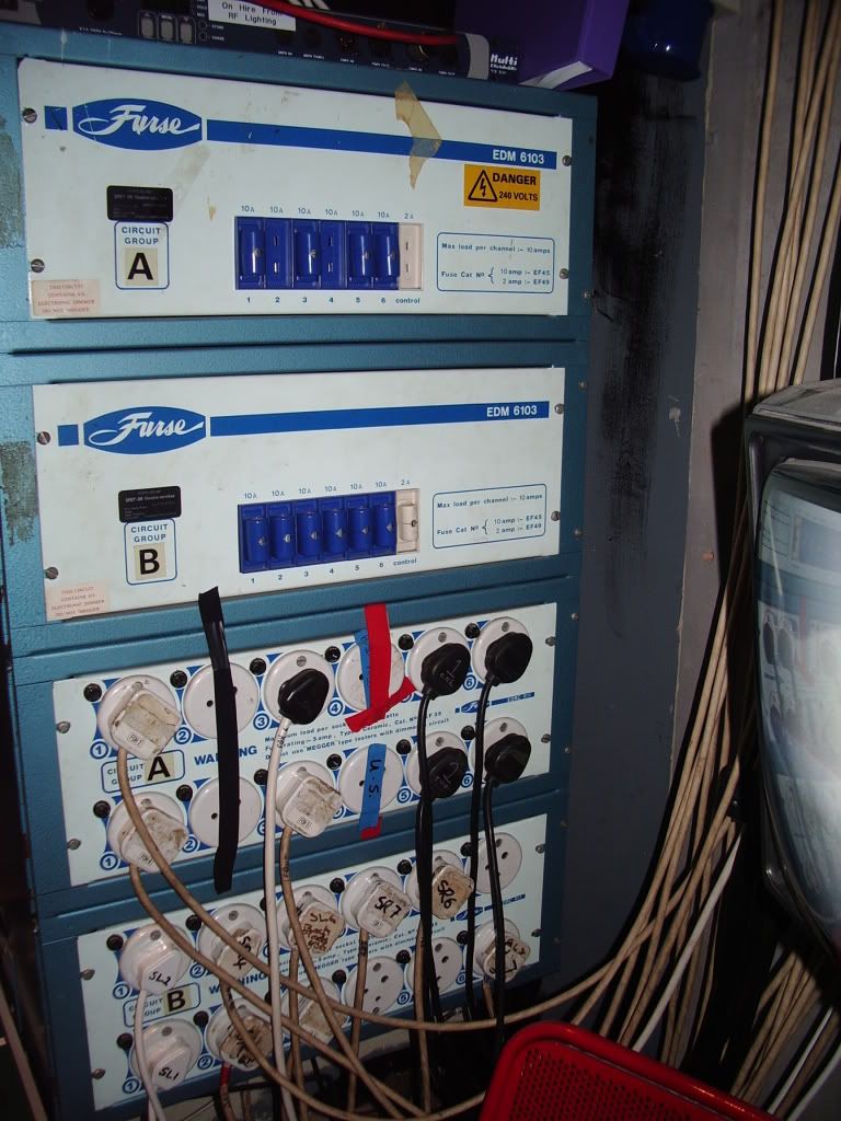

I've got some 5A sockets to install in a theatre. Each socket will be on it's own dedicated circuit, but here's the problem.
As 5A circuit breakers are not readily availible these days, I'm going to have to use either a 6A circuit breaker (preferred) or a 5A cartridge fuse (not ideal)
The socket will often be running at the full 5A, and there is the possiblility to overload it.
What do people think to this?

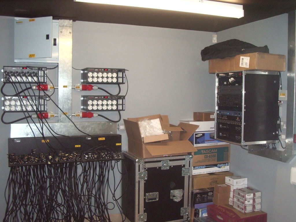

Because it's in a theatre. The dimmers have 5A sockets on them. There are lots of 5A plugs which plug into the dimmers to distribute power to where ever it is required in the building.
They are wanting some non-dimmed sockets to allow other pieces of equipment such as discharge lighting to be plugged into the same sockets.
Imagine this but with 5A sockets instead of 15A
Are they essentially TP extension leads?! 2 sockets per phase for each MCB, what size breaker is in there?
They are in their simplest form SP extention leads. The flexes terminatein the black box behind the plugs and then fixed wiring goes to sockets all over the theatre.
On these dimmers, they are fed with TP supplying 2 pairs of sockets per phase. Each pair of sockets are fused at 10A on these dimmers.
Ah, I see now, I was actually referring to the dimmers when I said TP extension leads! So, on each of those dimmers can you control the levels on each individual socket outlet? Not seen that set up before. (sorry OP for unrelated queries!)
Each of the dimmers in the pic are 6 channel dimmers with a pair of sockets per channel. The level of each channel is individually controlled.

We've got an old furse dimmer with 5A sockets on, and the cables plugging into it are on 5A plugs. We want to be able to send non dim power down some of these cables.
