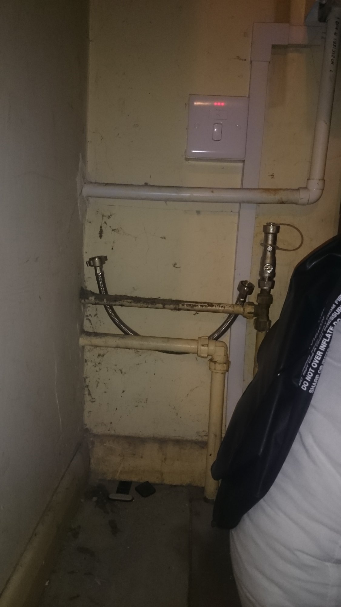

Hi all. I am looking to install a pump in my boiler cupboard. The cupboard is next to the bathroom. The 90 degree pipe in the corner is the hot water feed from the storage tank to the sink/bath. The only power in the cupboard is the boiler supply. Can this be spurred from for a single socket?

But in the main even a 3 amp fuse in a FCU would be enough. Clearly needs RCD protection as well. However one is not allowed to pump from the mains supply so when the combi boiler was installed the law required the power shower to be removed.
The picture
full
seems to show a filling pipe used with combi boilers so I question if your allowed to fit the pump?

This is a condenser boiler, Also isn't the mains supply a reference to the cold water entering the house? I am wanting to pump the hot water into the bathroom from the hot water storage tank. If i have to, i can fit the pump into the cylinder cupboard and use the CH wiring centre

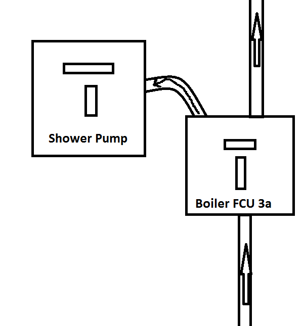

Can't you spur off the FCU as the current is limited by the fuse in the FCU?
Only if you spur off the output.
But the suggestion was:
"I'd pull the cable out of the existing spur, put it into the supply side of the new spur, then take a new piece of cable from the supply side new spur to the supply side of the spur".
Which you cannot do if thr spur is off a ring final.
When you say 'spur off of the output', is this what you mean?
