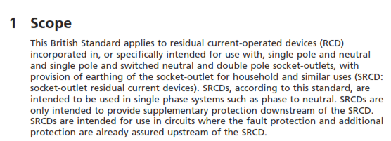

The decision that they are no longer suitable was made by the persons responsible for producing the product standard to which these devices are manufactured.
This would be PEL/23/1.
so bs7288 clearly says :-
so until pel23/1 reword bs7288, or there is a product modification then they are now effectively obsolete and will remain a non compliance and omitted from bs7671.
